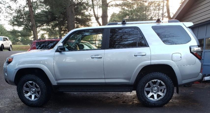

Here's what it looks like:

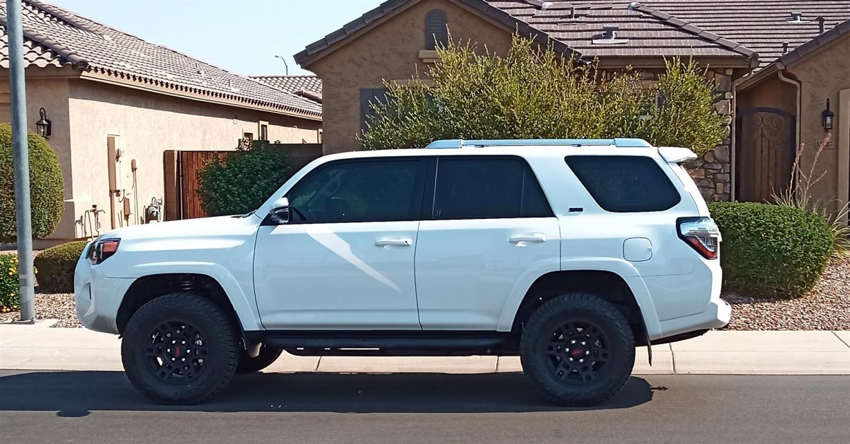

Here's a pic - I apologize in advance if it's sideways or way too large (or if it doesn't show up). I haven't uploaded pics here before.
The driveway slopes towards the front of the car, making it look like it has more rake than it does.

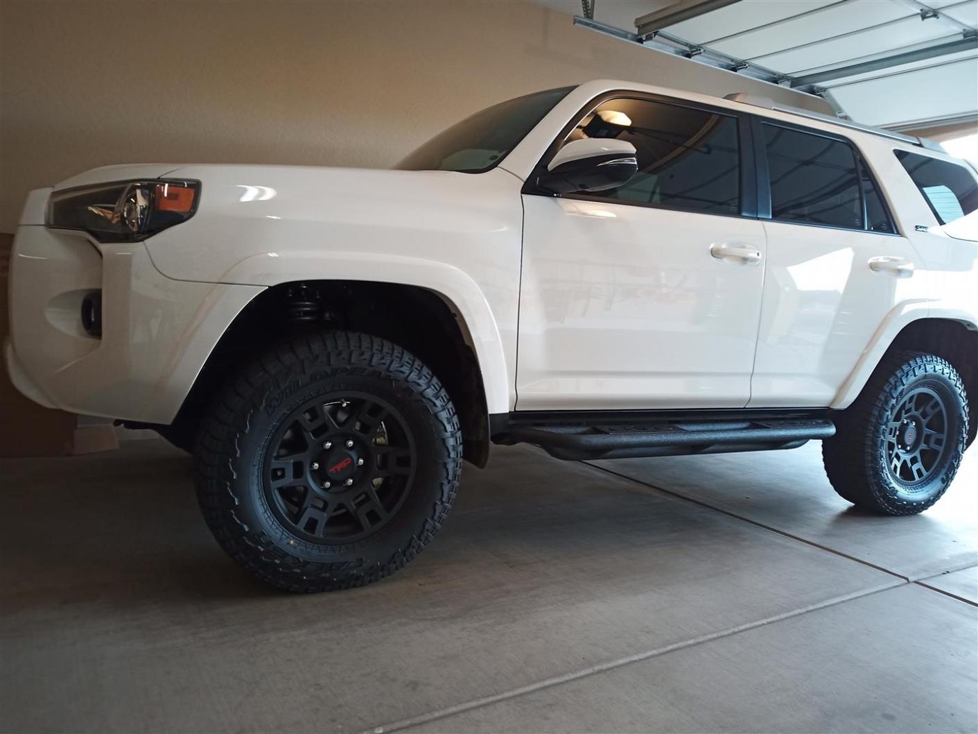

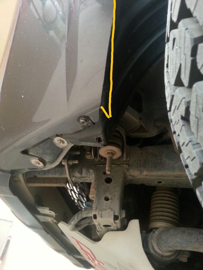

Rubbing has more to do with your wheel offset than your lift. If you rock some super trendy -30 offset wheels, you can rub with 265s. If you are running trd/trail wheels you can run most 285s with no lift. I tossed my 285 pirellis on pro wheels while im waiting for my suspension and its fine. I trimmed the bumper before I installed them but there looks to be plenty of room and it may not have been neccesary. I have plenty of room at the body mount. id probably hit the fender liner above the mud flap if it flexed but hitting speed bumps at full lock still clears.
Fwiw, the bumper trim and liner relocation probably took me 30 min with a dremel and you couldnt tell its not stock. You really just hack off the little corner that turns into the wheel well.
If you really don't want to trim at all, 275/70/17s would be the safest bet. With factory offset wheels, you could likely fit 285s with only removing the mudflaps + high caster. There may be some trimming needed on the front fender. I believe they trim the pros slightly to fit the more aggressive tires with the +7 offset (trail wheels are +15)
Here's a photo of my 285 MT01s on factory trail wheels. Full compressed. Just barely clears haha
