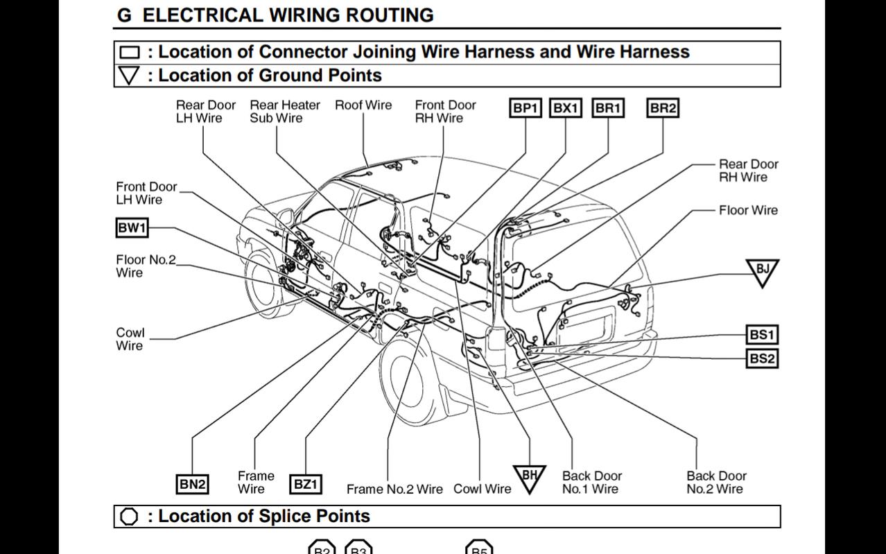

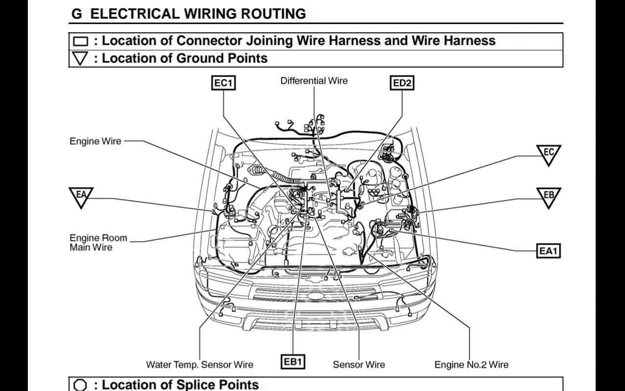

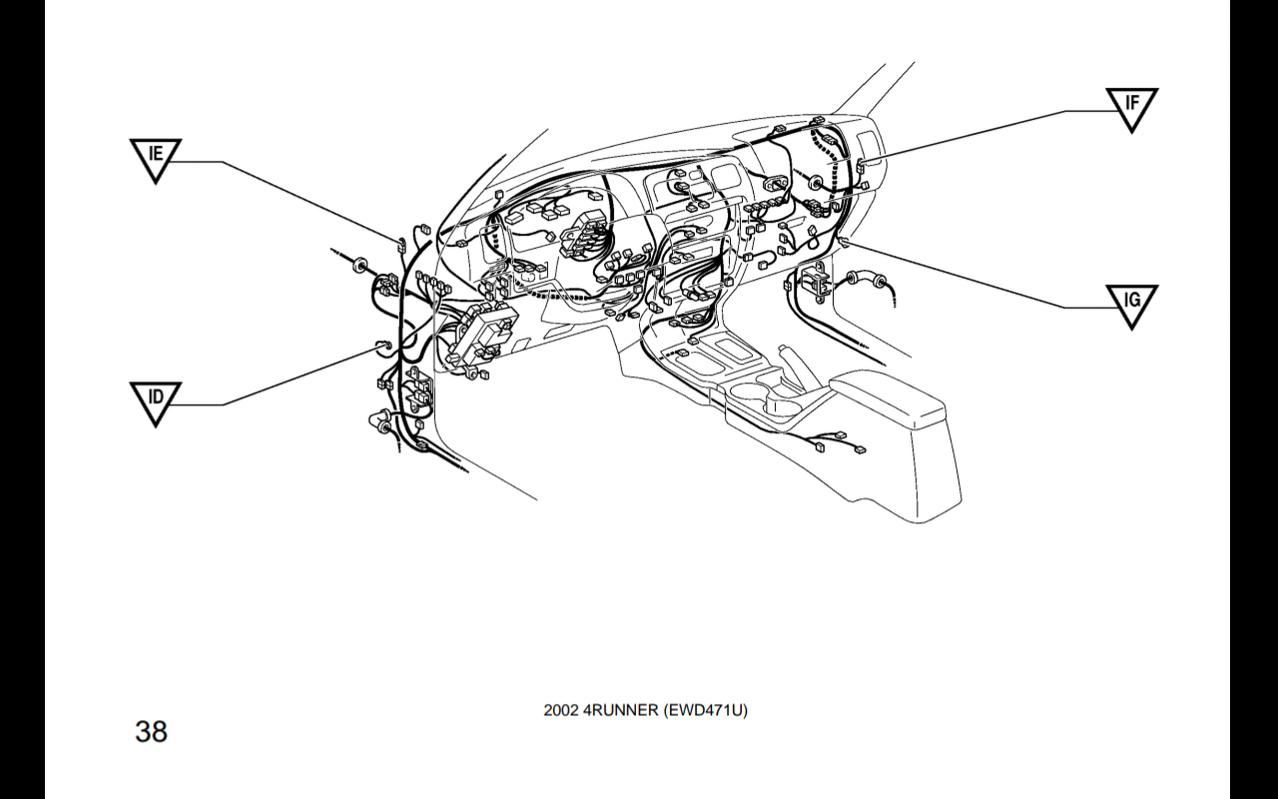

which grounds do i check other than the gaggle by the intake?

The intermittency sounds like you might have a short in your wire harness somewhere.
I would visually inspect all wiring under the vehicle and engine/transmission looking for worn insulation, possibly even animal/rodent damage.

Another possibility that I have been experiencing (and have the parts to fix, as of yesterday) - a problem with the circuit board on the back of the gauge cluster.
My errors have been P1780 and at separate times the left turn signal would activate the reverse lights...
I say this because, like grounds, the gauge cluster is about the only place the gas gauge circuit and the transmission control circuitry comes near each other.
-Charlie

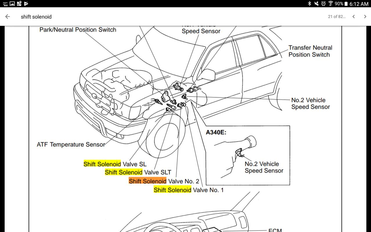

Well, I think it was just a coincidence. I drove around some more and the gauge drops if you accelerate quickly, which is probably the sending unit. My VIN falls under replacing the pump/sending unit and circuit board on the cluster, according to the tsb. The shifting issue seems intermittent on its own. Would the shift solenoid b electrical(P0758) cause slipping and sometimes shifting from 1 to 3 , skipping 2? Once it finds a gear , it won't slip under hard acceleration at all, only between gears. Thanks.
Well, I changed all three shift solenoids. It is still throwing a CEL P0758 and still losing second gear. What is my next step? Do I ohm out the wires between solenoid b and the ECU? it drives great in first, third and od, it's just second gear that is having issues. I don't want to rush into swapping in a transmission if it's an electrical/ecu issue. Please advise guys. Thanks.
