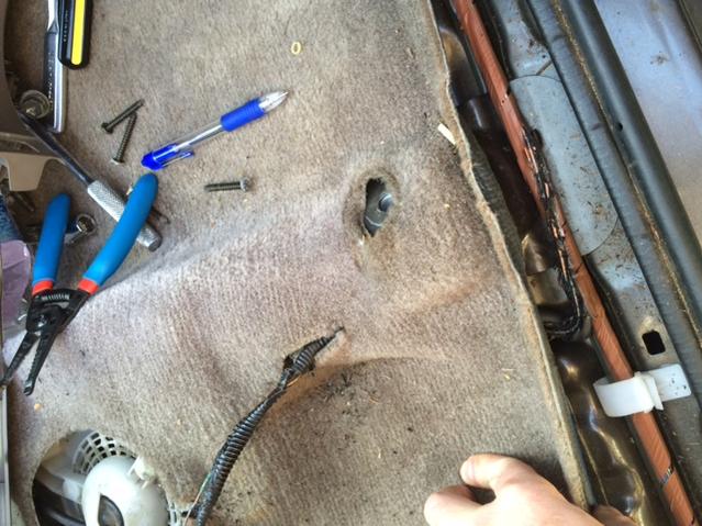

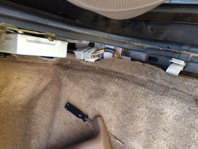

Not the best pics, but while I saw the burning wires under the seat, it looks like the most upstream portion was under the carpet by the door. The one on the right just shows where that portion plugs in; I couldn't see much, but the wires looked fine upstream of the plug.
Really weird the fuse didn't blow--in fact, I haven't even had time to figure out which ckt pwr windows, pwr locks, brake lights, and gauge lights are on.
Any advice? I think I'll just try to replace the portion of the harness that plugs in by the ECU(?) on the front right kick panel, replace the fuse (which I assume has blown now), and then be on my way? Best way to ID what portion of the harness I need? Best place to buy it?
