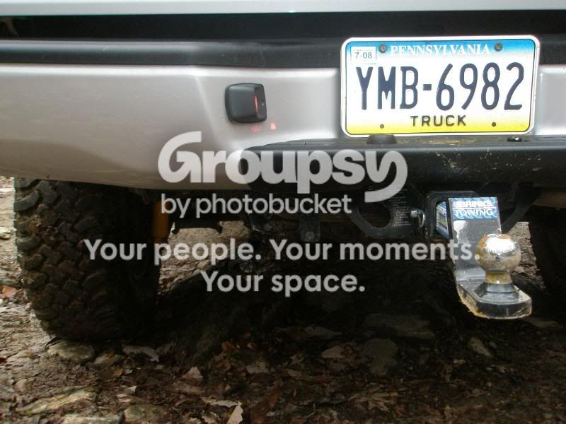

I haven't done it on the 4Runner, but I did it on my Tacoma. On the Tacoma is just hung down waiting to get ripped off:
PC300392.jpg~original

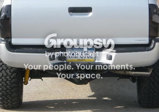

so I drilled a hole in the bumper and put the connector there. Plus I got a duel connector to allow for a flat or round connector.
connector.jpg~original
The hardest part will be finding a mounting spot. good luck.
