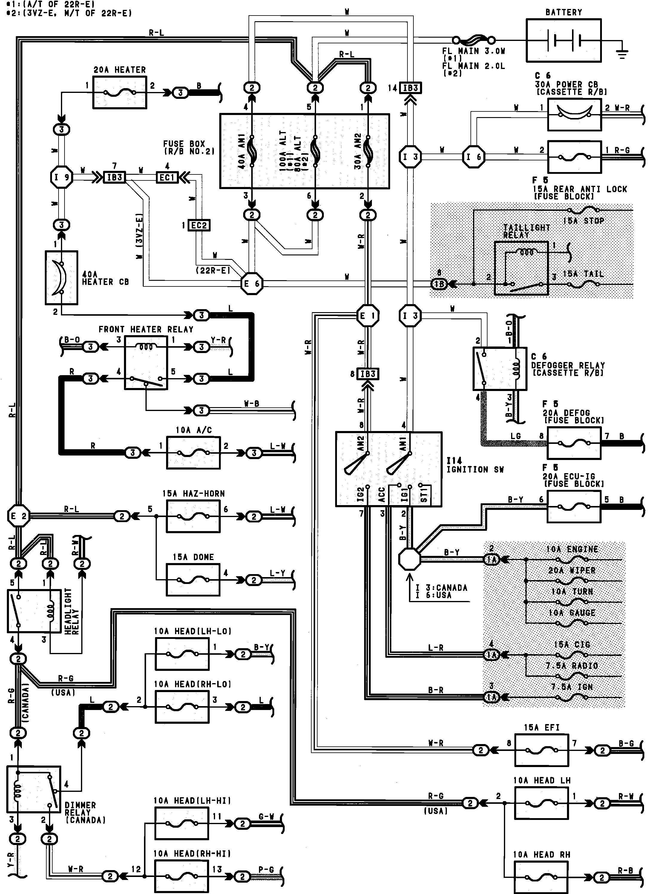

If you show us exactly what you are/were looking at, we can show you where to check based on SaulG's schematic^^^
:fishing: perhaps
Thanks SaulG!
