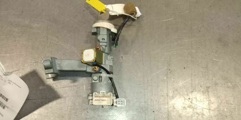

If not, then remove the steering column covers and remove the wire switch unit at the end of the ignition key (held by one Phillips screw). Have the key off during this removal. see the condition of the electrical switch unit. You can turn the switch with a screwdriver (engine will start when it is turned to the furthest). Steering wheel will stay locked. If you suspect this unit, replace it. These switches hardly fail. Non of my toy's switches ever failed. If someone pull too much power from this switch into their accessories, then it can melt the wire pins inside the switch, otherwise, these are life time.
