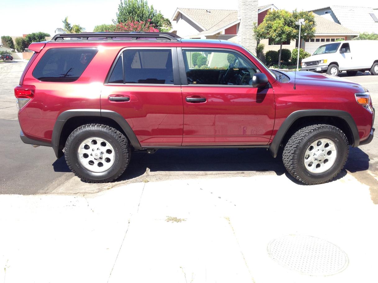

Here's a new pic with the 5100s installed at the 1.75" setting.

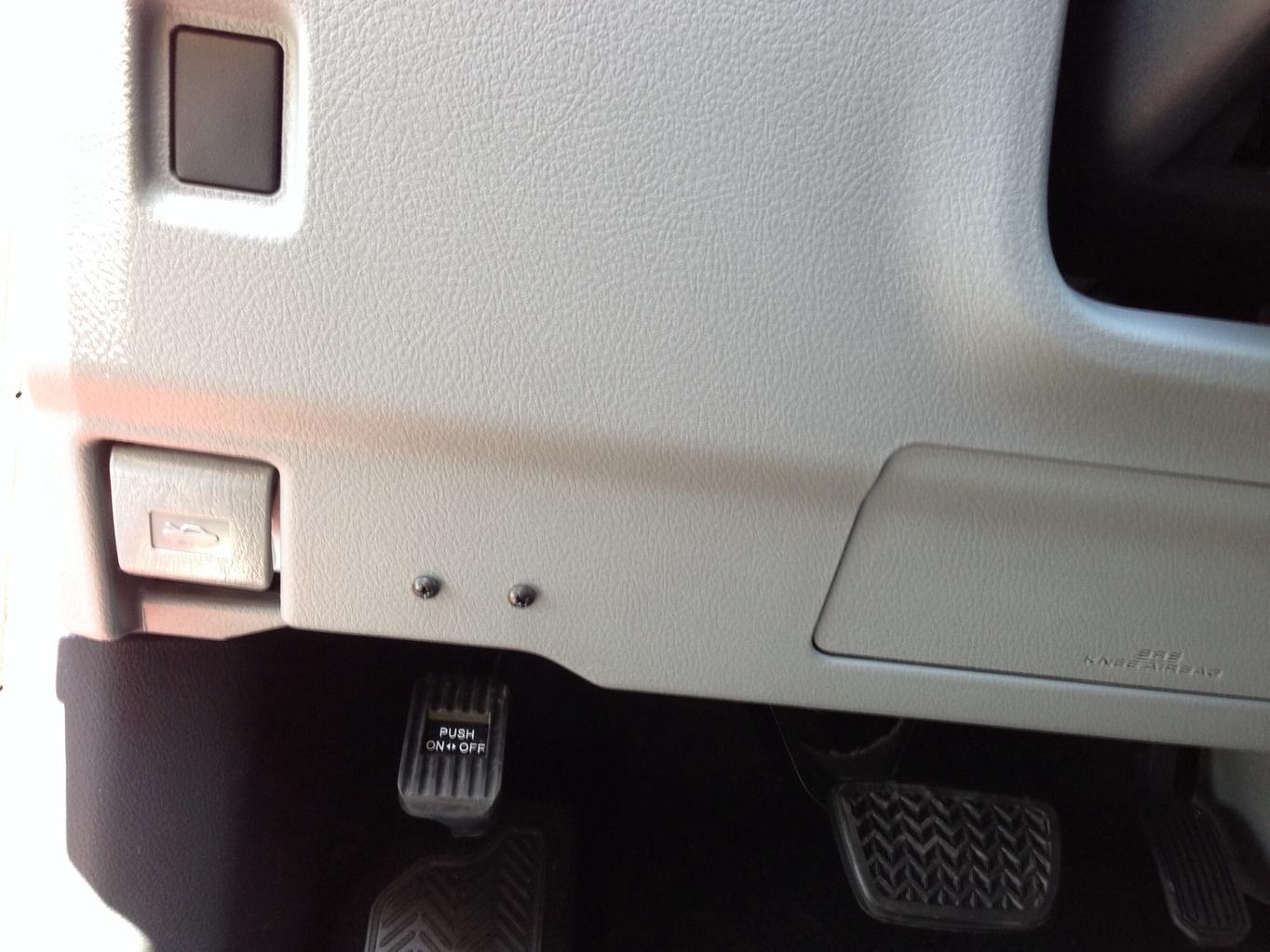

So now I'm left with a decision. There was a small plate on the lower left of the dash that was part of that alarm. After the removal it left two small screws in it's place.
My dealer will replace the panel if I want them to but I was thinking "what could I put there that would use those two screws?". So I told them to wait on ordering the replacement panel.
Here's a pic of the screws.
