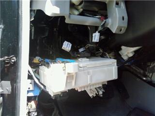

here it is removed- it sits on top as it is now or behind when mounted

Electronic flasher worked perfectly for me. Getting to it is hard. Must take apart half of the lower dashboard, running board and side kick. After finally getting to it, i had to break it off. It's complicated but much safer than resistors.
