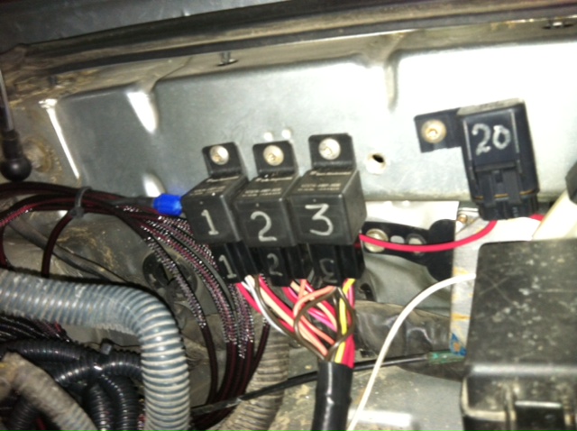

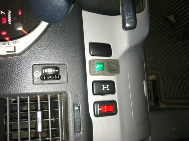

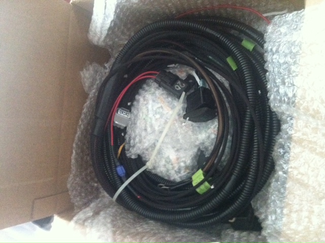

hey guys today i completed mt elocker retrofit, ive been waiting on my harness that i had made by offroad solutions. i went with their harness for 2 reasons 1 its a complete drop in harness theres no splicing anything together and 2 the switch is similar to the arb style its not some ugly toggle switch that looks like an eye sore in the truck. the install was very easy and went well the harness basicly lays right in place where you want it, the hardest part was getting a few wires through the grommet in the firewall. i def reccomend these guys if you plan on doing the retro fit the price was 163 shipped and worth every penny yea its 20-30 bux more but for a flawless drop in harness and no splicing to deal with its the better buy. hope this helps some of you guys.
its not a direct drop in so dont think that it take a fair amount of modding to get it done. search elocker retrofit google it you get alot of results
correct electrician, here some pics of the harness switch mounted and relays mounted.
