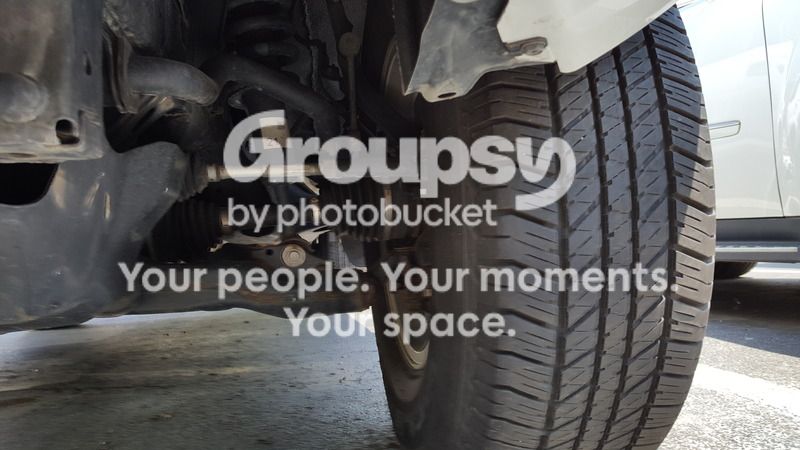

Locally (3 miles away) I found a Trail premium with 28k miles for 33k$
"Downside"
20160524_120618.jpg~original
am I going to hate life without it? or should I bite on the local buy?

The person who traded that in could not live another mile without that sweet, sweet KDSS.

I just don't understand the obsession with KDSS. It is seriously overrated in my opinion. It's OK, but really I would personally pay a premium to not have it (but I have a different use case than most folks).
I was never impressed with any of the ones I drove with a stock suspension (KDSS or not) In fact, the klunk of the KDSS turned me off right away and then when I looked under the truck I immediately knew it was not for me . If you plan to keep it 100% stock... KDSS may be the way to go, but most people who come on here want a bit more).

I don't know this for a fact, but they most likely removed KDSS because of reliability/compatibility concerns. I'm sure the real engineers were iffy on if KDSS could work at Toyota reliability standards with the TRD lift and they did not want to spend the time or money testing it out. Somewhere along the line Toyota has pushed info down to dealers... saying that KDSS and lifts are not compatible. Wrong or right, it is seems to clearly be their view on the topic.
Additionaly, it does not take a genius to look at KDSS with a lift on and see that the bushings and angles up front are all bound up. Is it a big deal, no. Will it impact how long the bushings last... absolutely.
I'm not saying a lift is a major problem with KDSS. I'm saying it is not recommended from Toyota's perspective. And there are some quirky things that do happen with some (not all) of them once lifted.

I say do it. KDSS is a noticeable difference that I think you'll notice in your case. I sure as hell did in mine (for reference, I work in a cubicle and 95% of the roads I've ever driven on since I've had my 4runner we're paved or concrete). There are PLENTY of us here that have a lift, bigger tires and KDSS.

KDSS is cool to have, and does improve cornering, however, it's still a heavy vehicle with a high center of gravity. I previously had a TE with KDSS and currently have a LE without it. Can't say I miss it.
