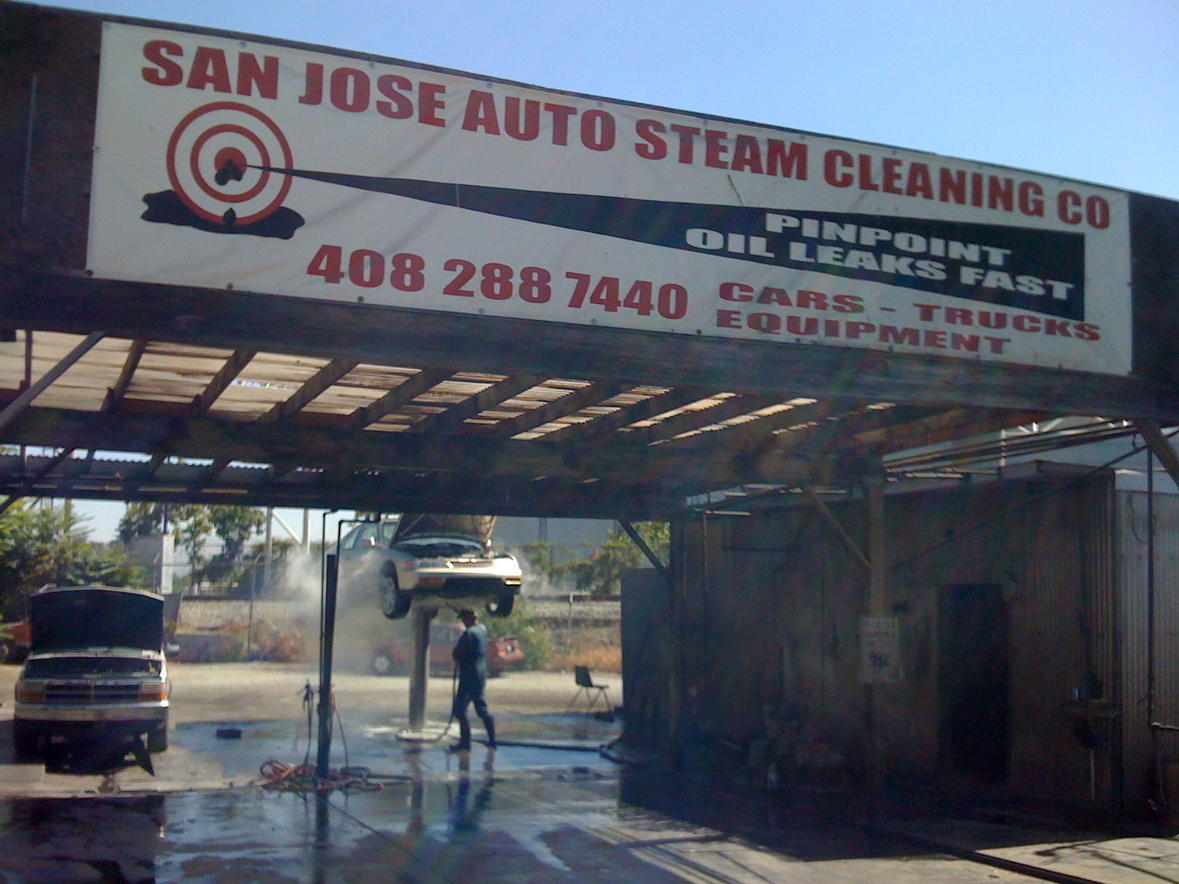

For years, I've always taken my cars to a local steam cleaner in San Jose, CA.
They use a high pressure nozzle steam hose. The steam is mixed with a soapy degreaser to cut through the muck faster so as not to get the engine bay too soaked for too long. It's best to drive in with a hot /warm engine so the heat helps evaporate the moisture after the spray down. After steaming, wait 20 - 40 minutes before starting the car or inspect the ECU and electronic components for dryness before starting.
The heat and steam make it evaporate much more quickly than a cold hose rinse down. There are lots of these services around, usually coupled with car wash businesses. They typically offer engine top and bottom and undercarriage bottom cleaning. They put the vehicle up on a hydraulic lift outdoors and have at it.
Here's a photo from years back of my 1995 Accord getting steam cleaned. I had her done 3 times and never had an issue. My Infiniti G35 coupe has been done once, no issues. My T4R has been done once and looked brand spanking new afterwards and makes it a joy to work on cleanly. It also helps pin-point oil and tranny leaks if you have any. I'm due for another cleaning after all this summer's off-roading in Nevada.
