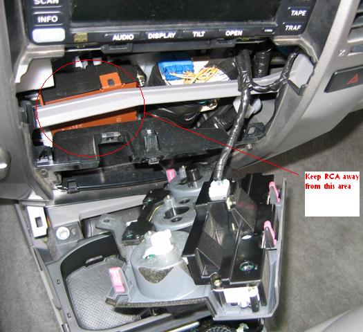

For those of you who have had engine noise issues.. I was playing around with the RCA's off the deck and found and area with high levels of interference. Keep away from behind the climate computer on the left side. It was the cause for all my problems!
