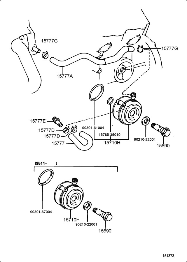

There are block off plates that Toyota used in place of the liquid-to-liquid oil cooler, in less demanding applications of the 5VZ-FE.
Unless it's plugged or leaking, the engine is far better off with it in place. If it is plugged or leaking, I personally would replace it with a new one.
As far as I know, all 3rd gens with the V6 have the oil cooler. At least every 4Runner with the V6 I've seen, has it. It's located just further back from the oil filter, on the side of the engine block. Part #15710H is the engine oil cooler.
Assuming that there is space between the oil cooler and the exhaust, one could retro fit a uz oil cooler and run a second oil filter.
