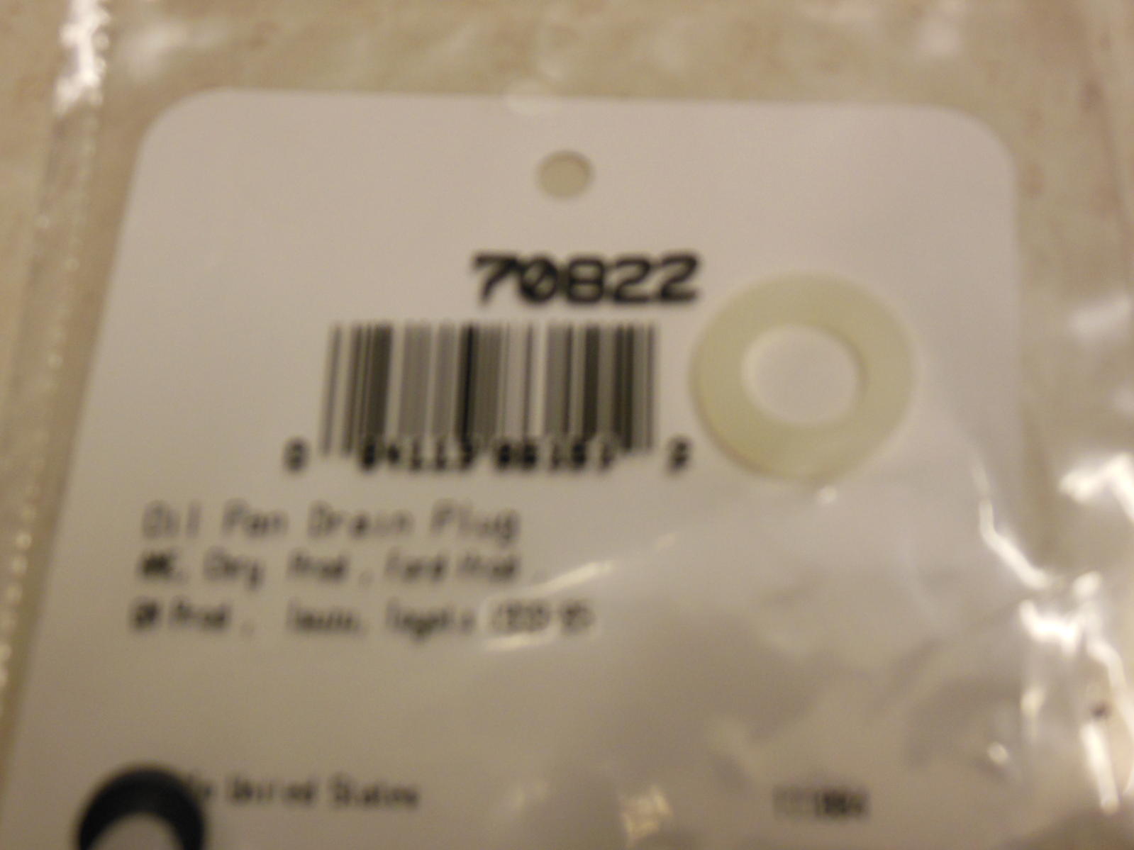

Recently I changed the oil bolt gasket with toyota fiber gasket. It started seeping oil. Upon removal, saw the washer is in two half washers.
I then found the following in local auto store. My personal feeling is plastic is much better as a gasket than a rigid fiber. This gasket is made by FelPro who makes gaskets for many applications and I hope this will do its job. It also comes with 1 year warranty. Anybody have experience with this gasket?

I have that felpro drain gasket on my 01. It's been 2 years and no leaks or drips. The old one crumbled. A copper or aluminum gasket is fine too.

Here are the OEM washers that as far as I know work on all Toyota oil drain plugs at least gasoline engines.
+1 for highlife dimensions as I got the same off the OEM washers.
Copper or aluminum washers with those specs will work. I go copper as your have metal reaction is you use aluminum and why the OEM have paper on both sides of the aluminum washer...;)
