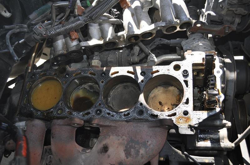

I think I found the problem...
A car smart friend came over and we pulled the plugs and found two completely rusted out. We pulled the head and found the HG blown out in four spots.
When I was vacuuming the water out of the cylinder some was coming out of the channels in the block and it looked exactly like that. So, I am assuming that all of it is that bad. The radiator was completely flushed in January, and the rust stained the gutter for half a block.
