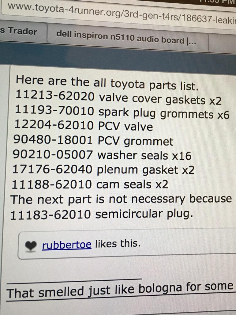

My ‘98 has been having this problem since I got 14 years ago. Lately it has become really bad, about 6 months ago my mechanic replaced all valve cover gaskets but the problem only seemed to get worse. Not sure what to do with this 4Runner, it still looks great gets decent MPG and the engine “only” has 280K on it.
