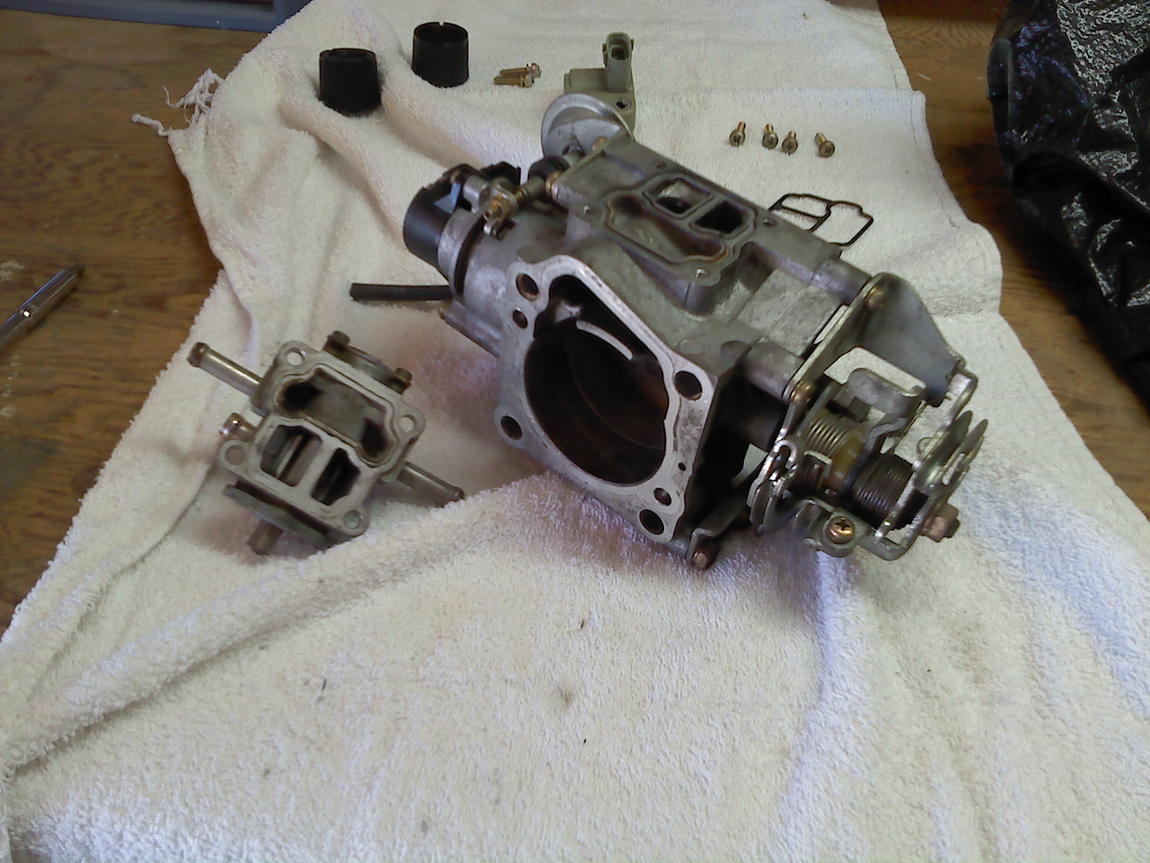

Same thing happened to me a few weeks ago. It would not idle on its own, but would stay running if you were on the throttle.
I pulled the throttle body and discovered that the IAC valve was stuck closed from carbon build up. I cleaned it with carb cleaner then lubed the moving parts with Tri-Flow. Fixed the problem.
Let me know if you need more details on how to service the IAC valve.

When the same thing happened to my 4Runner, I explored all possibilities, but everything pointed to the IAC valve. The engine ran fine at 1,000+ RPM's which means the fuel pump was working, and the timing was on.
