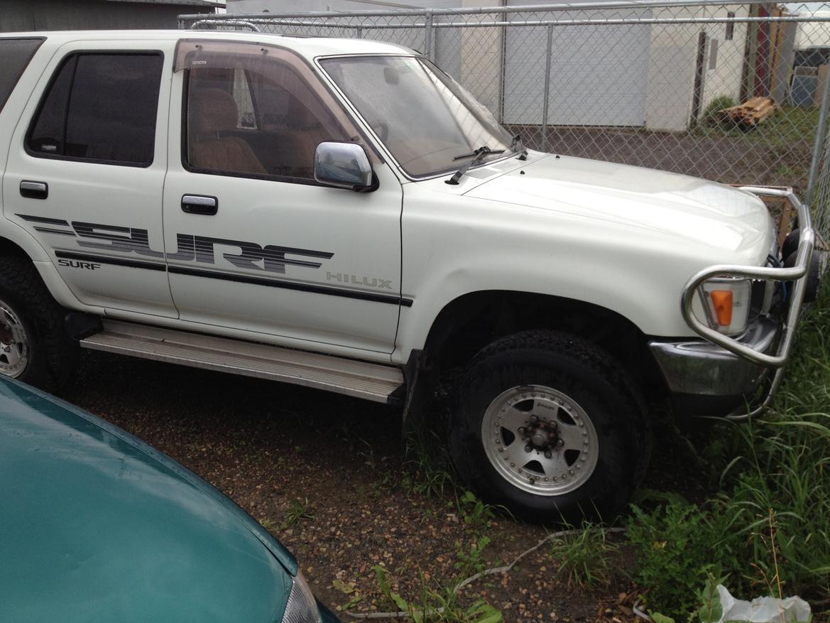

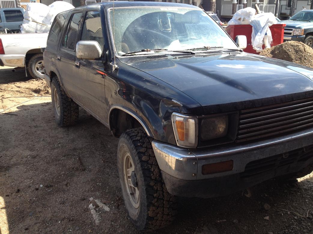

Well the 3.0 was just fully rebuilt 25,000 Kms ago and runs flawlessly and money and time is the current issue winter is coming I bought the 3rd gen for a mere $800 and everything about it is mint except the motor and everything about my 2nd gen is fubar'd except the motor which is flawless. Now yes one is 2nd gen and one is 3rd gen I know in your eyes I am going backwards but I have a method to my madness lol the chassis are both the same layout etc yes going diesel to gas and 3rd gen to 2nd seems backwards but since this is a dd project at this point I have both vehicles and its either going to be swap everything from the 3rd gen into the 2nd ie windows doors fenders running gear axles tranny front end rear end, interior etc etc etc orrrrrrrrr just swap the motors and ecus for now.
You see I have a trip in 3 weeks to bc to see my daughter an go to a family reunion it's a 1700 km drive each way and I am on a budget and time frame this is a necessity type swap which in the end gives me a reliable dd which is in flawless shape and I can slowly repair the 2nd gen and keep it for offroading. Make sense now kinda?? And I do t have to pay for the 3rd gen up front my buddy is giving it to me now and I can pay him after my trip.
I know it seems dumb in some ways but I'm just asking for help or tips to make this happen as fast as possible or so I know any major changes I am going to face the electrical doesn't scare me at all btw I've done numerous swaps just never of this sort

You're in a unique spot. Not many people have a fresh, good running 3.0 and a diesel that's shot in the ass. But I would think the swap would be somewhat simple. Just like your plan, park them next to each other, rip all the stuff out of the Diesel, then carefully move all the running gear from your 2nd Gen into the new one.
Most likely, it won't be emissions legal if that's a concern of yours up there. (It's a big deal in PA) It'll probably have issues with the instruments, power accessories, etc.
I personally wouldn't go through with this if I were you. I'd look to buy another 2nd Gen that you can swap your drivetrain into should the time come for that down the line. Or sell your 2nd Gen to someone who wants to continue to beat the piss out of it and pic up a 3rd Gen that doesn't have the issues this one does. My $0.02
If they're both 2nd Gens, which they appear to be. Everything I said above for the most part it moot. You should also try your luck in the Classic forum as you'll get better advice.

And those are definitely both 2nd gen 4Runners/Surfs/whatevers. Maybe the 2nd gen got sold for an extra year in Canada?
It's a 96 from Japan RHD so is that 2nd and yeah very small differences body wise
