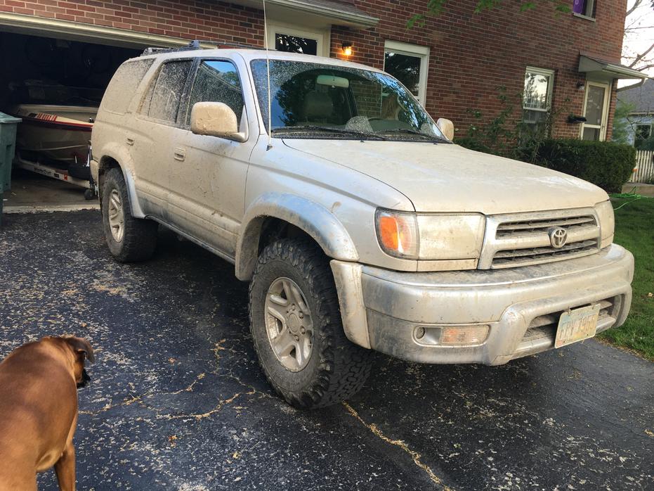

About 100 miles and three days after some extensive water and mud exposure (no submerging), I am getting an escalating whine under hood. It sounds like a power steering pump whine but it is contingent on RPM and not effected by steering input. I am guessing alternator as it was hit with a lot of water, weeds and mud. I have no charge lights but sound is getting louder. I have not put a multimeter on it yet. Is this sound something that could be coming from an alternator? If so, is failure certain? I am going to crawl under at lunch and get a better look to see if it is full of mud but if I know it is going to fail, I will address it now. Thank you for your help. IMG_0363.jpg

Cool, I'll give it a shot of LPS 1 when I get home and order some bearings on Amazon for $7 ea if that is the problem. The mud I was in was in a swampy area and was very sticky goopy clay, like a thick pudding. Once dried, it turns into almost a baby powder type consistency so it was a it was a prime scenario for getting it contaminated with particulates. I appreciate the advice.
