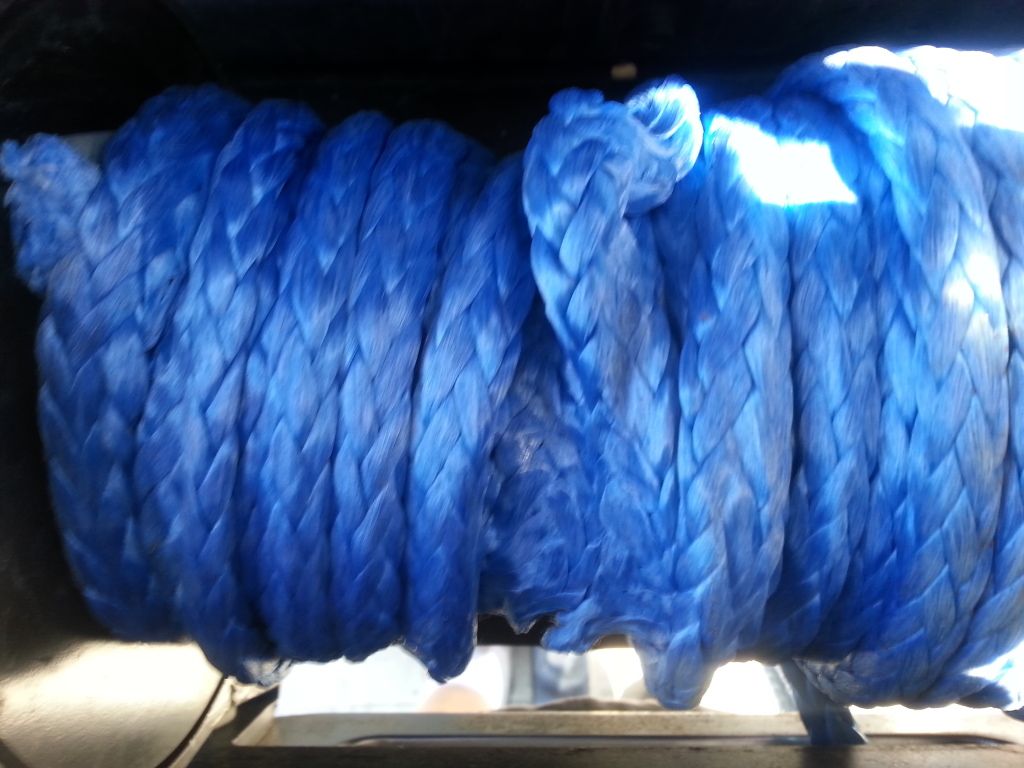

Used mine for the first time today. After spooling out just a couple feet of line, I found this:
20140712_132549_zps8b164144.jpg~original
It's fouled badly. I'm sure I can untangle it, but I'm more worried about whether I can trust it after it's been kinked like that and then sat for who knows how long. This is my first winch, what do you the rest of you think?
wow, i would not trust it. i wonder if anyone else has this issue. call engo and see what they will do for you. i dont care how great the winches are, what separated great from good is the customer service that backs great company!
sucks balls that you need to use it and thats when it fails.
I cant see the photos on the DOD computer here at work but it sounds like the rope is distorted from the wraps lapping over it, is that correct? You said today was your first time using it, did you properly dress the winch and rope before today? Meaning did you unspool all but the last wrap of rope and hand feed the rope back onto the drum under a light load? Doing so pre-stretches the cable and readies it for your first pull, otherwise the rope tightens on itself as the slack is pulled out, potentially damaging the inner wraps of rope.
I didn't, I didn't know that was necessary. But the rope isn't just distorted, it's looped and kinked and squished under the upper layers, and this was before I'd ever spooled it out.
I've got an email into Engo, we'll see what they say.
It's not necessary. I don't have to do that when we do the warn winches with synthetic rope.
Hindsight is always 20 20. Should have could have would have lol.
Now all you can do is hope engo does the right thing by you.
When I switched to synthetic from metal. I "walked my truck" while using the winch to reel it in so the line would be spooled right.
Yeah its in the instruction manual under installation. This is something that always needs to be done, no matter rope or cable.
AND YES IT IS NECESSARY, EVEN ON WARNS.

Ok you right, I'm wrong. Feel better? I meant spool it out. Since the synthetic is not pre installed. And it has to be installed. If you owned a warn or installed one you would know what I am taking about. Personally I do, personally I have installed warns. I looked at engos prior to my own purchase. I went name brand and something I was familiar with.

I kid, I should have read them better I guess. I'm not taking the blame for this though, because my spool looked like that before I ever put tension on that line. I found that while I was pulling it out to hook up the winch rope.
No you are right, this isn't your fault! Buuuuut if you had stretched the cable after immediate installation, an untimely discovery like this wouldnt happen on the trail. Either way, I'm sure Joel will take care of you.
