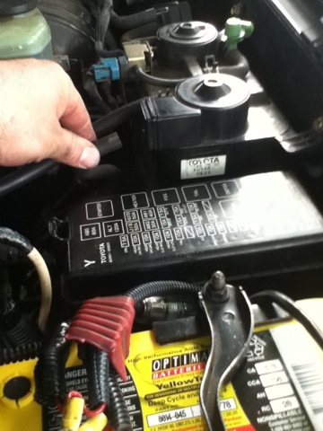

my fellow 4runner brothers and sisters. whilst changing my battery today i appear to have broken off the air drain hose from the evap canister.
ive searched the fsm and while i couldnt find anything related in the 2000 t4r, i did find some info on the taco fsm which i assume should be similar if not the same.
question i have is where does it go and what will be the result of running disconnected. at idle i did not notice anything different or cel's or anything. all seemed normal.
As far as i could figure out, when the pressure (air?) builds too high in the canister, a valve opens and releases (air?) but i dont know to where, or why.
i found the attached drawings in the taco fsm but i cannot find where the line goes to in any drawings. as far as on the rig, it was starting to get dark out and i could not trace the line from top side or underneath. it disappears somewhere heading towards the tranny and by the time i am underneath, i cant really identify where it comes down.
im unemployed right now so $200+/- on a new canister is not really an option for me at the moment. id be willing to try a repair but im not very confident in reattaching such a small and weak piece of plastic with any success.
So anybody familiar with this part of the system? any advice is greatly appreciated. attached is a pic of the broken air drain connection and a couple pdf's from the taco fsm.

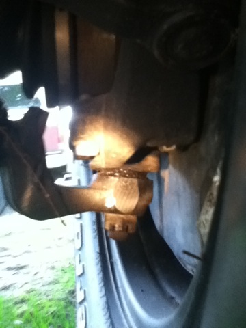

so i crawl underneath trying to trace this line and guess what i found? yup, Split and broken lower ball joint boot. The grease didnt look all that fresh either. I inspected it a few months ago and it looked fine. Im guessing i most likely broke it up at browns a while back in the heavy peanut butter snow.
So as far as i recall the ingredients for lbj failure are lift-check, heavy bumper-check, high mileage (180k)-check, split boot- im guessing check.
Dude im not sure i should take this out right now. I was just thinking how paranoid i am of catastrophic lbj failure as so many people are experiencing right now.
with my current employment status i kind of think it would be wreckless to take a less then 100% rig into the field right now. I soo want to go though.
We'll see...
