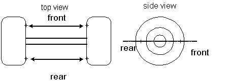

The FSM outlines a simple way to check toe by measuring the distance between TRE's.
You can also do it by picking an identical reference point on the inside sidewall of each front tire, at the front and rear of the tire. You should be able to draw an imaginary line from the front point to the rear that goes through the center of the tire.
Than measure between the front point on the left tire to the front point on the right. Repeat on the points at the rear side of the tires. The distance between the front points shoild be 1/8 - 1/4" LESS at the front compared to the rear of the tires.
see crude attached drawing

BTW, the 2nd method is how I adjusted toe after I installed cross-over steering, and my 36's are wearing evenly so far.
