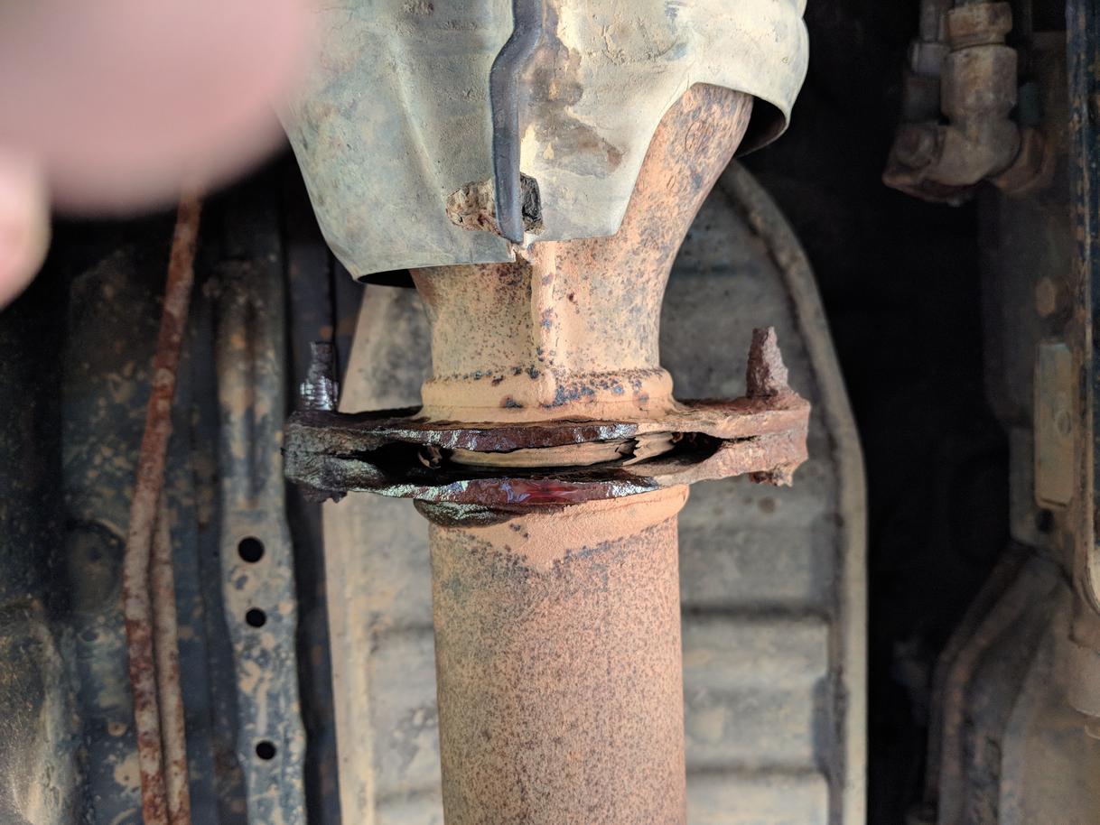

Hi folks - my muffler just kick the bucket. Now I'm left with a tailpipe corroded onto a short length of exhaust pipe. The bolts on the flange from tailpipe to muffler are completely destroyed from rust and I am hoping for some advice on how to go about removing them. The hottest torch I have is a Mapp blowtorch. I also have access to an angle grinder and drill. What's the best course of action here?

Yeah, don't count on saving it. I'd try a drift punch and BFH on the piece of bolt before I drilled, but that flange may be beyond repair. If it is not, you will also need a new gasket.
It doesn't appear that there is much of a flange to salvage. Keeping this in mind any reputable exhaust shop can weld a new flange for next to nothing and/or re-flare the pipe for you.
I know it seems logical to salvage the tail pipe because it's in good shape -- except for the flange. But addapting it will be more hassle, you'll spend a bunch of time and almost as much money, and you'll still have a cobbled together system.
You can get a whole cat/back kit here. It includes the gaskets, but you'll have to source 4 nut/bolt/washer sets from the hardware store. Don't bother with stainless or grade-8 -- just get standard. If you ever need to remove them, you cut them off and replace them -- that's standard practice for exhaust work.

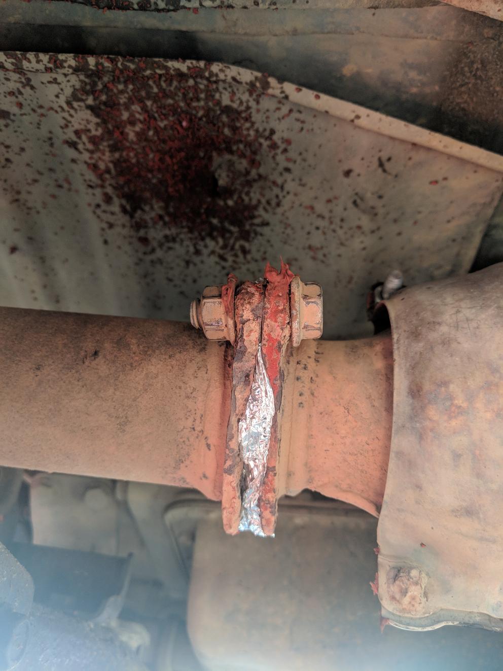

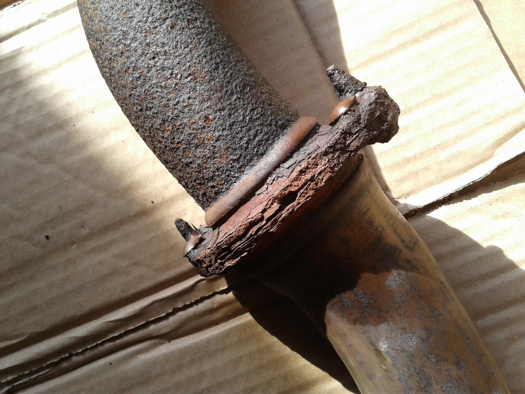

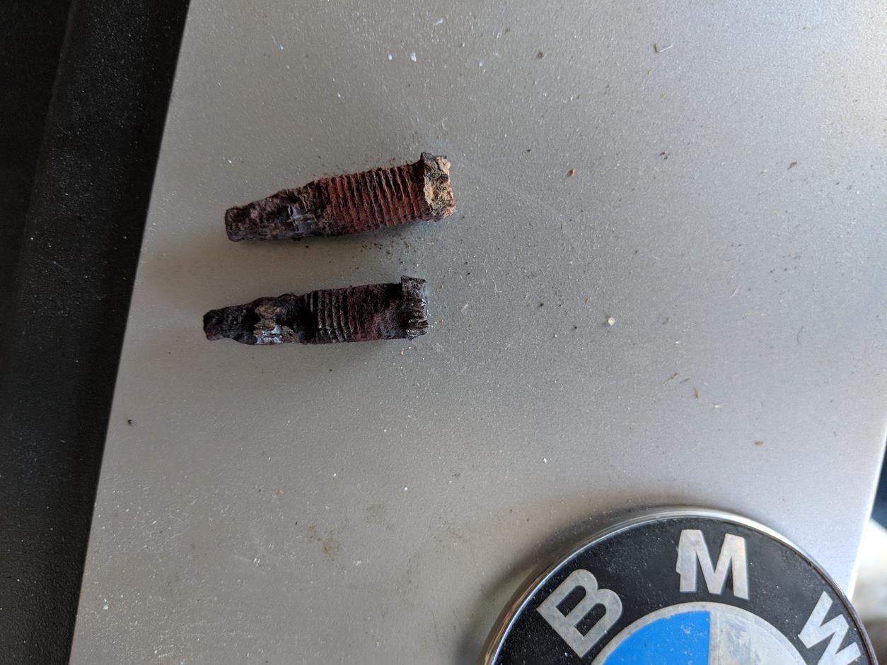

Pics here are from my pre cat flange. The gasket I bought was not enough. Ended up adding the heavier gauge aluminum foil in addition to the donut gasket. Have had the foil as a gasket for about 5 months now, still no exhaust leaks LOL
