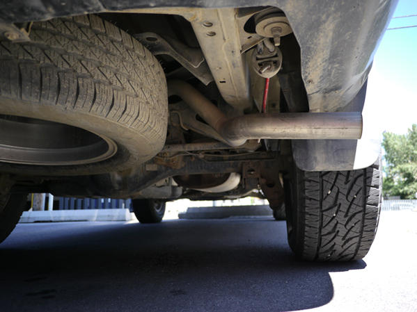

For the exhaust mod I had the shop weld in a single piece of new stainless steel tubing (resonator removed). See picture below.
