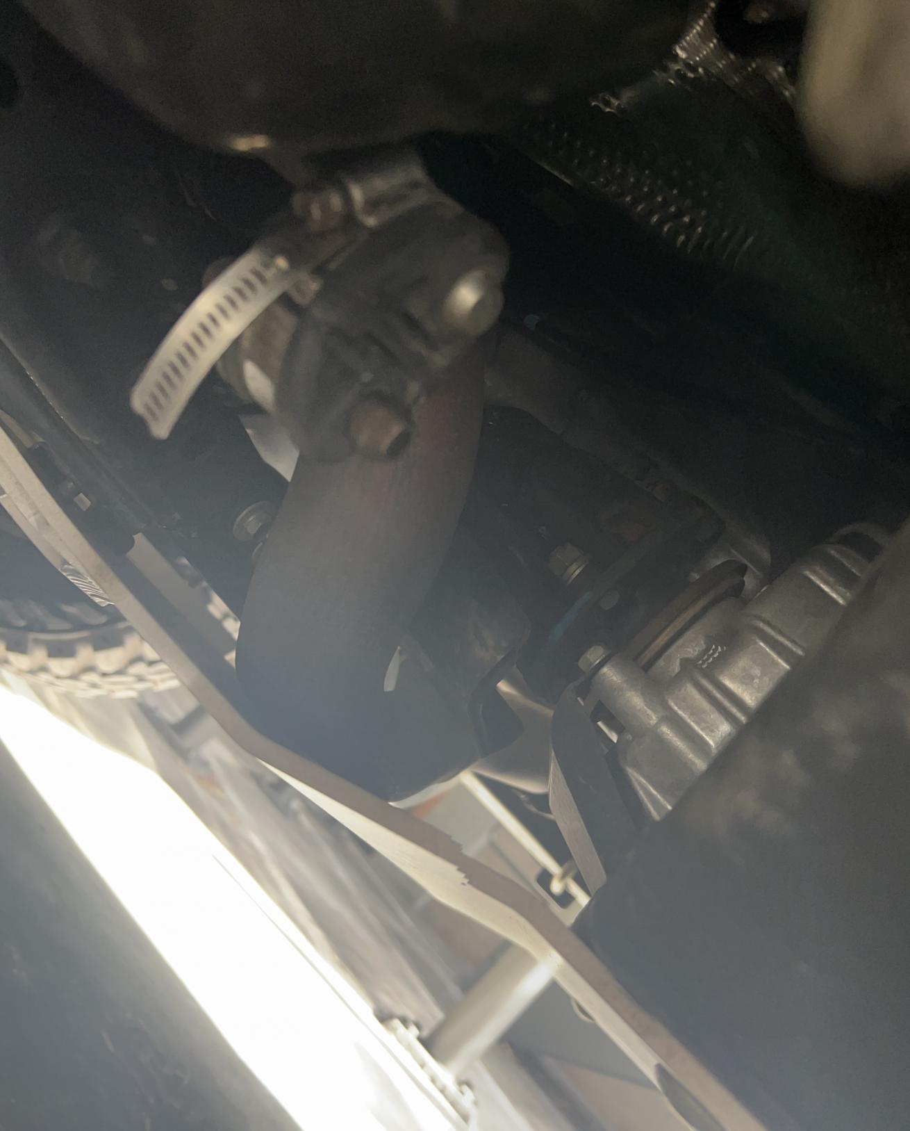

found my solution while just reading. awesome forum. clamp the exhaust up by the hanger... I was trying to bend that metal hanger upwards without success... lmao
That’s how I did it for last 6 years. It’s not fully rigid. You only do it to the point the pipe isn’t touching the skid plate.
I also used zip ties to lock to keep the clamp from moving. You can kind of see it in the pic ( 2 black lines)
This ghetto mod has been on this forum since the dinasours roamed the earth:first:.
That be muthar ****ing magic right there!!! thanks Brother!! I got hose clamps o plenty in the garage. This can be done!! :juggle:
It still moves plenty. Mine's been clamped that way for about 270k miles, all still original stock, and no problems
