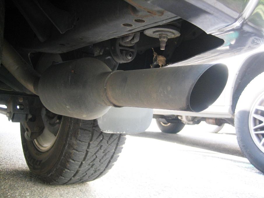

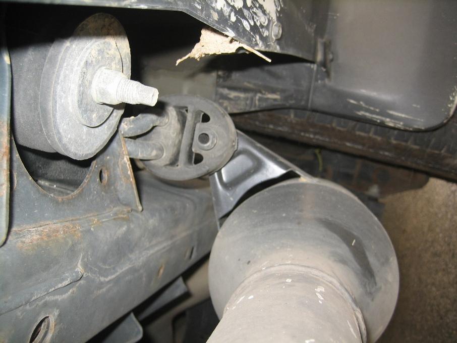

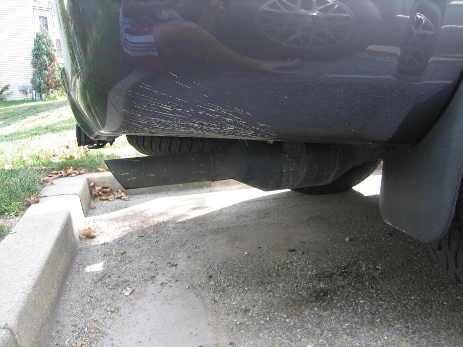

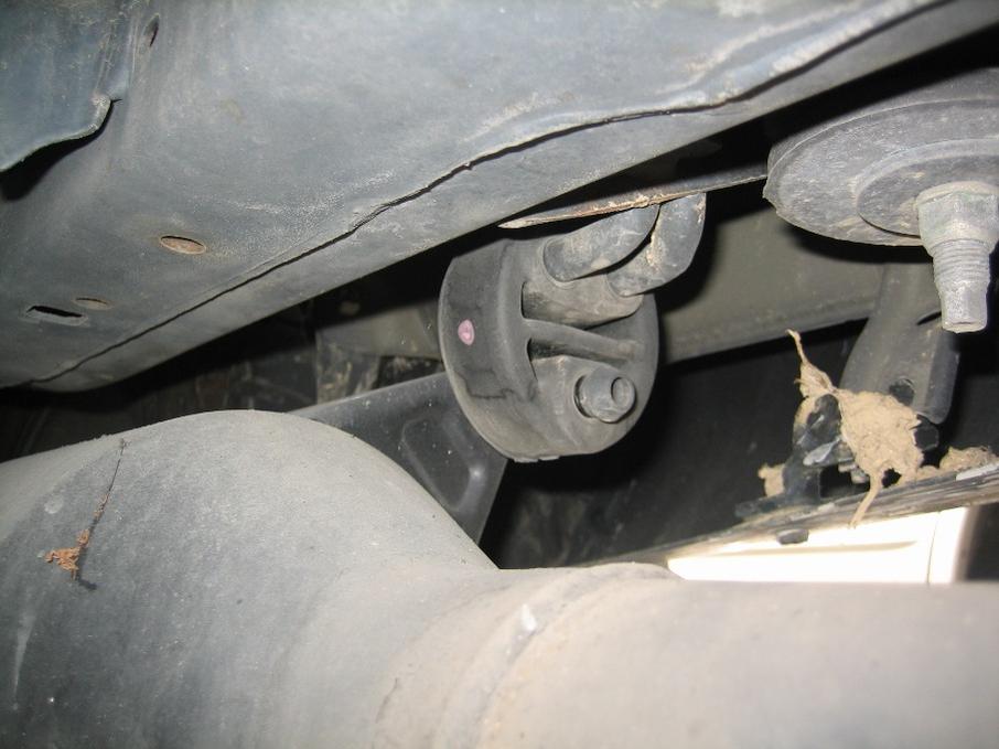

See attached. If there's something else you want a photo of, let me know!

That is extremely helpful! My pipe must be very bent because the piece that goes through that rubber thing is about 3 inches away from it! I think I'd better have it looked at after all, although I don't think airflow is being restricted. But, at least I'm not missing any parts! Thanks so much!
