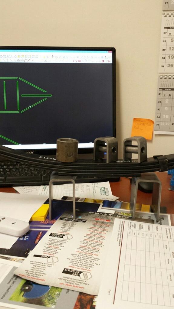

I've wanted to build one for a while. One of the thoughts I've had all along was how to make the suspension adjustable height so I can drop it down for highway cruising and bump it up for off-road.
I've really come to two different options. First is use a torsion axle with the longest arms I can find and build a mechanism to rotate it so it's a drop axle then a lift axle.
The other would be to just use some old fox air springs. How would I possibly fit a 20+ inch collapsed spring in though? And then I'd have to build a 3 link suspension for it - not a big deal, but a bit more effort.
Any other great ideas?
I figured the frame could be steel, the box and the rest I'd probably build in honeycomb/fiberglass/epoxy that I have left over from another project. It's insanely light and strong and allows for complex curves but kind of a pain to work with.
A-Arm suspension with air bags would be your best bet. This will allow you to adjust ride height but will change the ride characteristics (obviously rougher with more height/air). This will probably be the least complicated way to get an adjustable suspension on a trailer.
I opted to go with a simple leaf spring set up on my teardrop. Currently it will be spring under and when I have the clearance to fit it into a garage that isn't limiting me to a 7' height, I can simply flip the axle and do a spring over for 4-5" of lift and fit 34s (to match the truck).

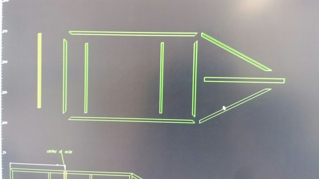

Just a suggestion, which is worth what you paid for it, I'd run that center tongue member back to the next bay to rear. Lots of pressure at that junction...but may be a non issue if you you use box steel, say 2" x 4". I'm sure Greg could finger it out as well...:hug:
