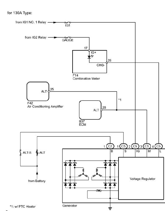

The diagram is for 5th Gen 4RUnners charge circuit. The M terminals is connected to the ECU and if applicable to other electronics, in this case AC amplifier.
All I want to know is if anyone can confirm the M terminal's function. Is it to send a signal to the main ECU to inform it of it's working condition or is it for the ECU to send a signal to the alt for control?
Im thinking that if the M terminal is only to provide a signal to the ECU, than I have nothing to worry about electrically and can just replace my original connector with the new one, and rewire the engine harness.
But if the signal is mandatory, because the ECU controls the alt in some way, then I will have to research further since I have no engine ECU and have to find out what signal is sent to the alt.
