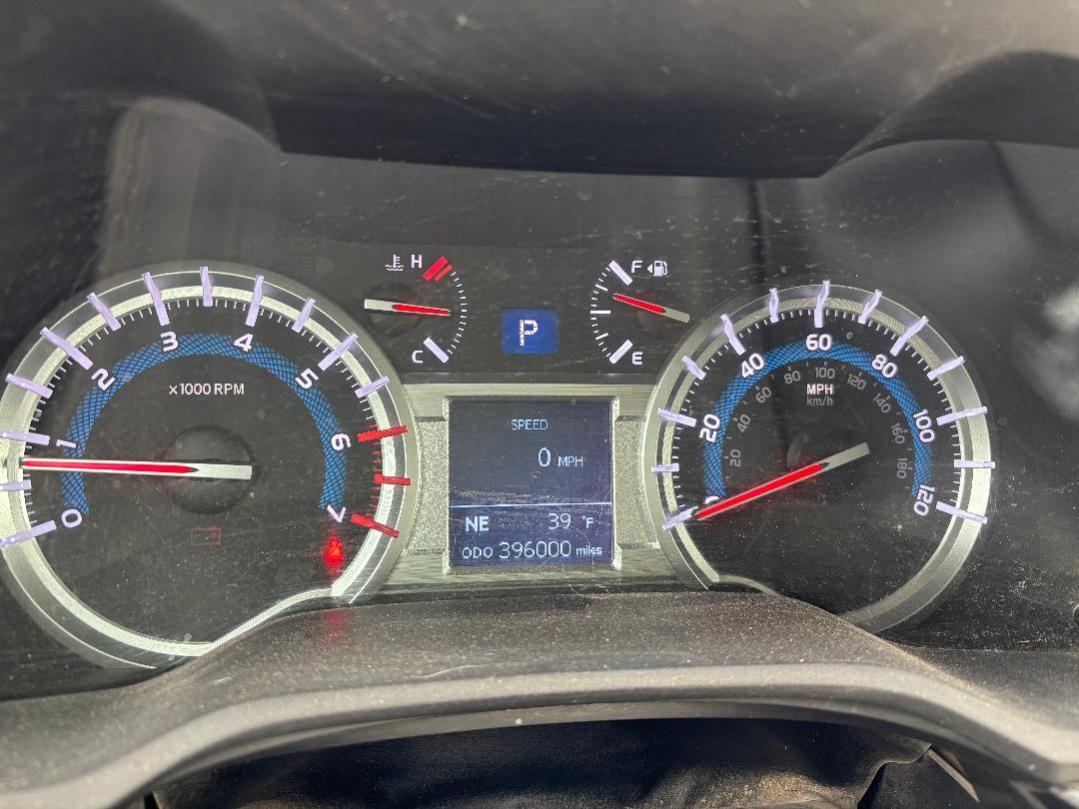

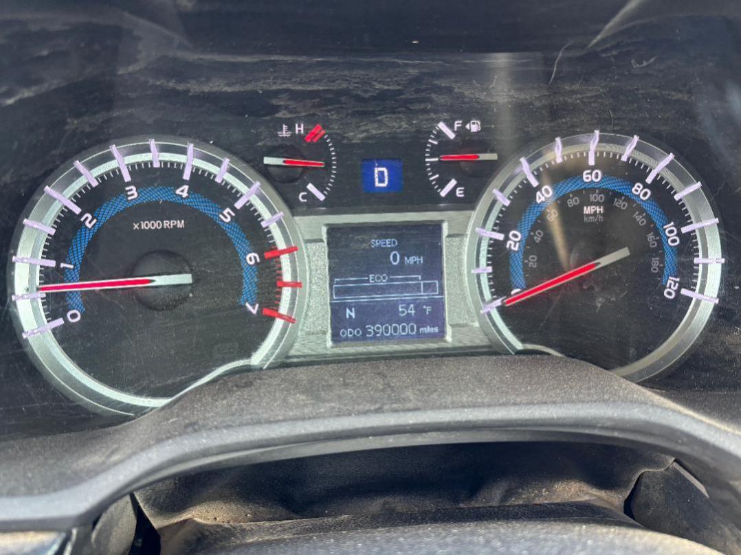

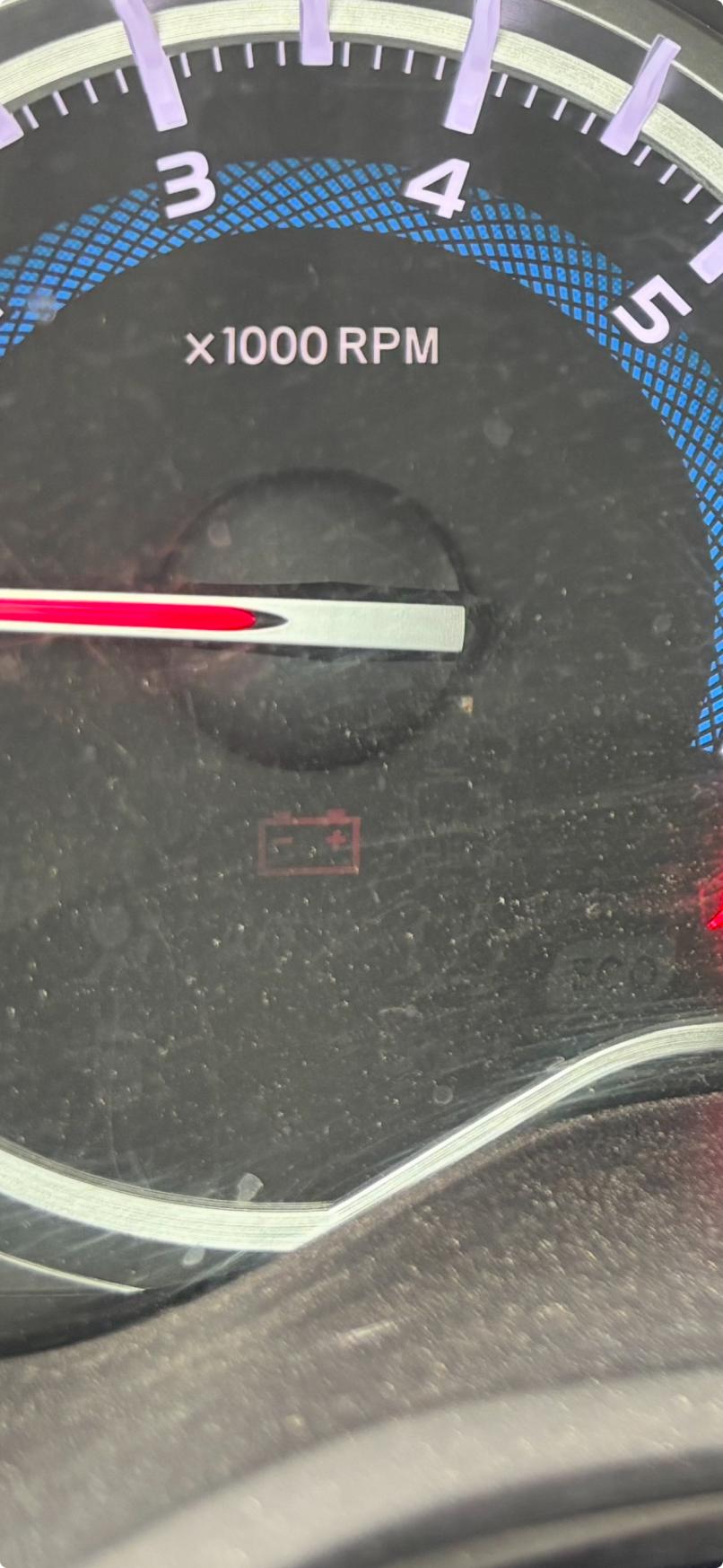

Alternator went out on the 2014 4Runner, stranding my wife in Mackay, Idaho (population ~500). Original alternator went 318.5K miles. I replaced with new Toyota Denso alternator and that lasted to 395.7K miles, or about 78K miles. Replacement alternator (do not know if it was new or reman, but it was $332) arrived late Monday and the local mechanic it in and sent her on her way. She made it to our Montana home late Monday night, with no further issues. However the battery charging system light remains feintly lit as shown in the following before and after pictures. Not sure what could be causing this?
Check the voltage with it running and also when it's off, running should be close to if not a little above 14V, off should be around 12.75/13.5ish.
Wouldn't hurt to check battery terminals and and alternators connections are good and tight also the serpentine belt is snug.
in order of my best guesses:
- the alternator itself just isn't that good. maybe it is remanned, maybe not toyota. that's where I'd start. maybe it's not putting out the right amount of voltage. a faint light would mean this could be a cause
- then move onto wiring. corrosion, poor ground etc. will cause voltage drop
- lastly the belts
given you didn't get much life out of the second alternator I'd place bullet 2 ahead of bullet 3.

Finally got around to testing with the voltmeter. I get 13.92 volts at idle and at 2,000 rpm.
I noted that the very feint charge light slowly come on the same speed as the gauge illumination.
interesting. alternator is basically charging to spec. 13.9v is pretty typical for these 4runners. maybe just a tad under the 14v. could that be the faint light cause? maybe. or perhaps one of the internal diodes that converts AC to DC is just not working like it should. causing the computer to be confused and maybe throw a dim light. aside from checking all the ground connections and wiring , throwing a new alternator in to test would help you narrow fairly quickly. I guess you could swap the alternators between both 4runners and see what happens

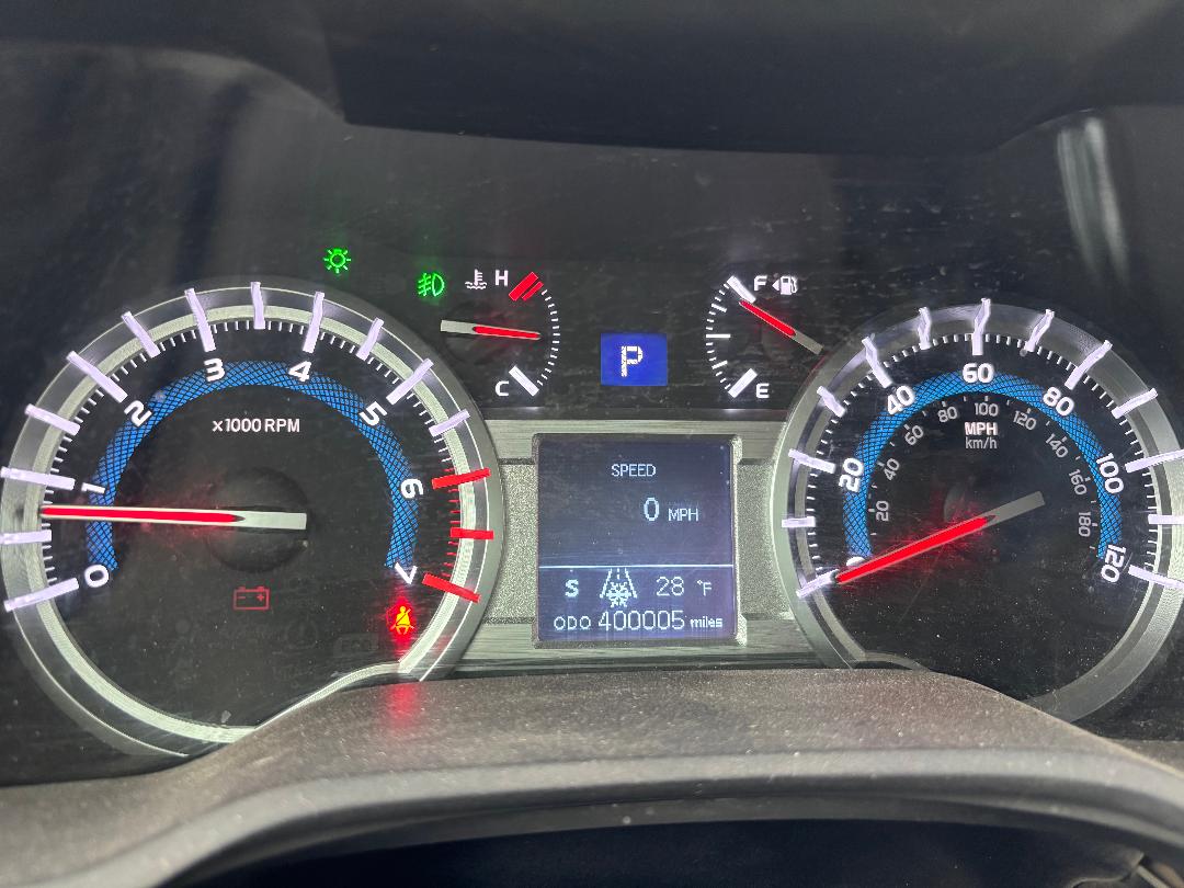

Here’s a pic from today taken because the vehicle rolled past 400K miles, but it shows the feint charge light:
Comment from TheTruckStop.us forum was to set the multimeter on ac and test the battery side lead at the alternator for ac. They too suggested it could be a bad diode.
