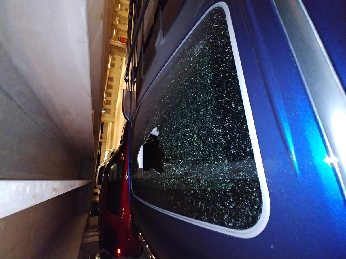

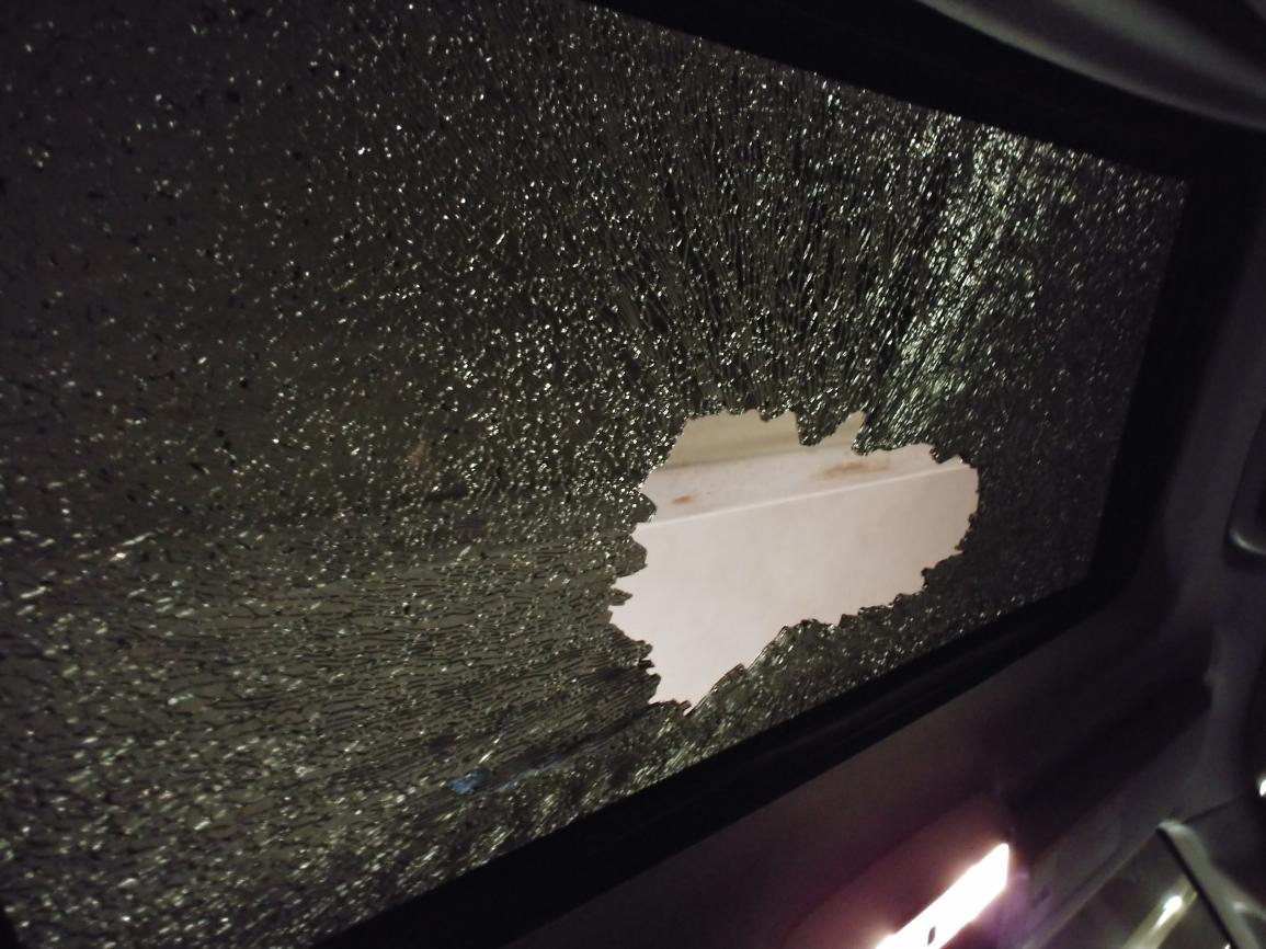

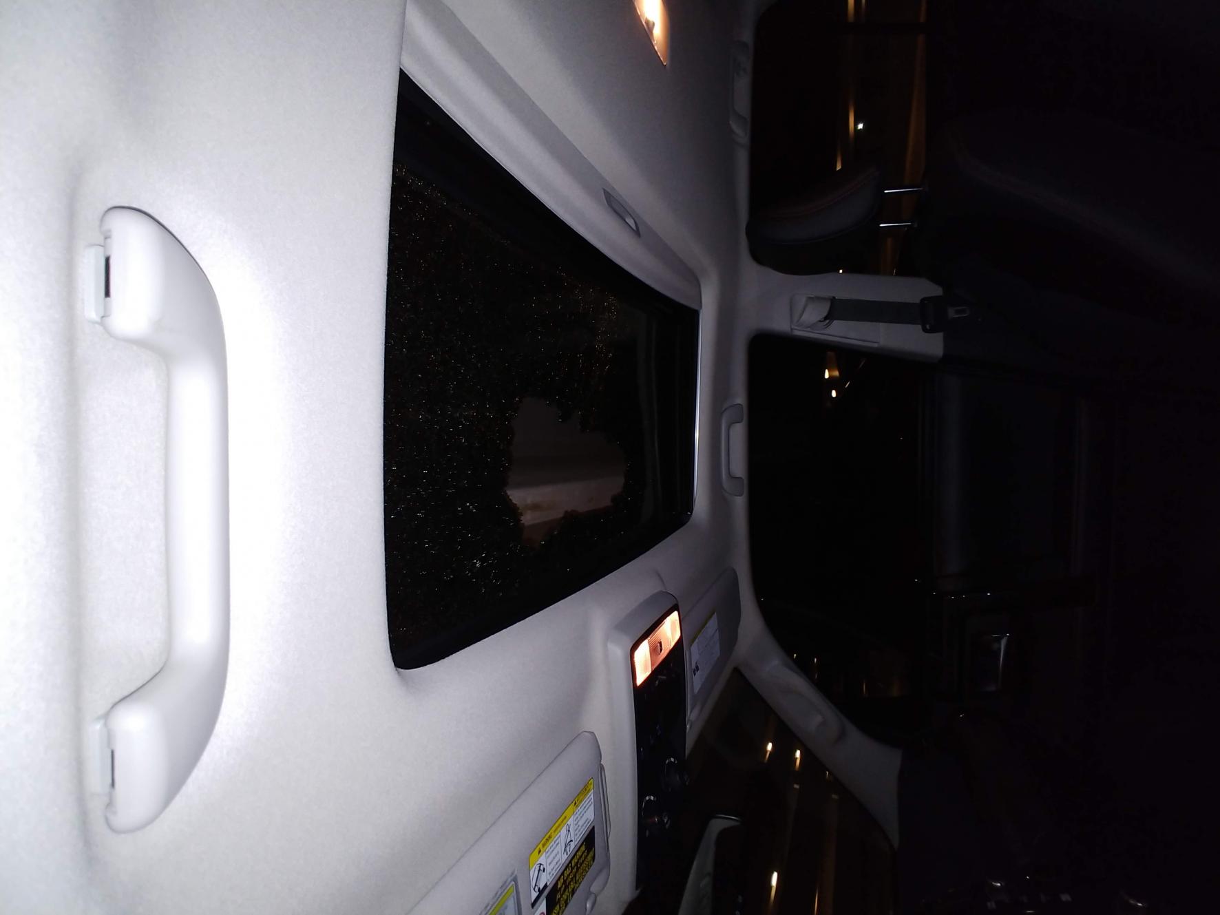

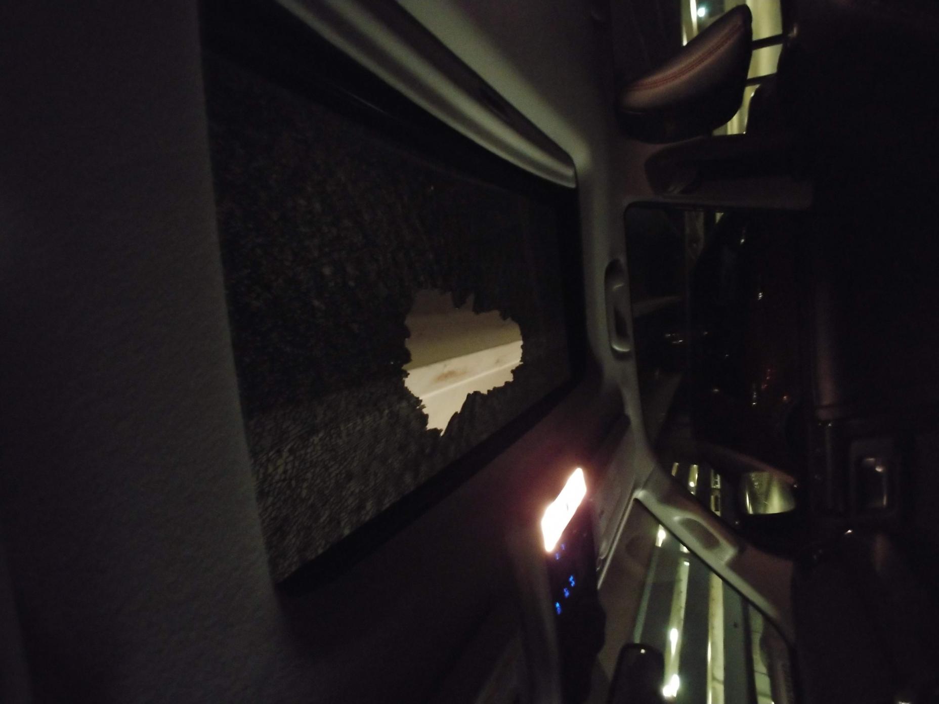

This JUST happened to me today. Was driving to the office, and it sounded like a bomb went off in the vehicle, and i was covered in glass. :(
Somewhere in the glass that fell onto you lies to source of the failure. Looking at the pictures you shared, I can see the fracture pattern moving away from that central area.
Chances are quite good that this is due to a Nickel Sulfide inclusion in the glass. This is caused by contaminants (like stainless steel) entering the glass melting furnace and embedding in the glass as it begins forming. Once the glass is formed, it has permanent stresses that are overcome only by re-heating through the tempering process which changes the stresses.
I know GM is extremely sensitive to this and has burned my company several times on failures in the field.
Jason, thank you so much again for this! This is really some good information. I went to the dealer this morning, and they attempted to say that a stone must have hit the sunroof... I challenged them, and have now involved Toyota. Will keep you posted
