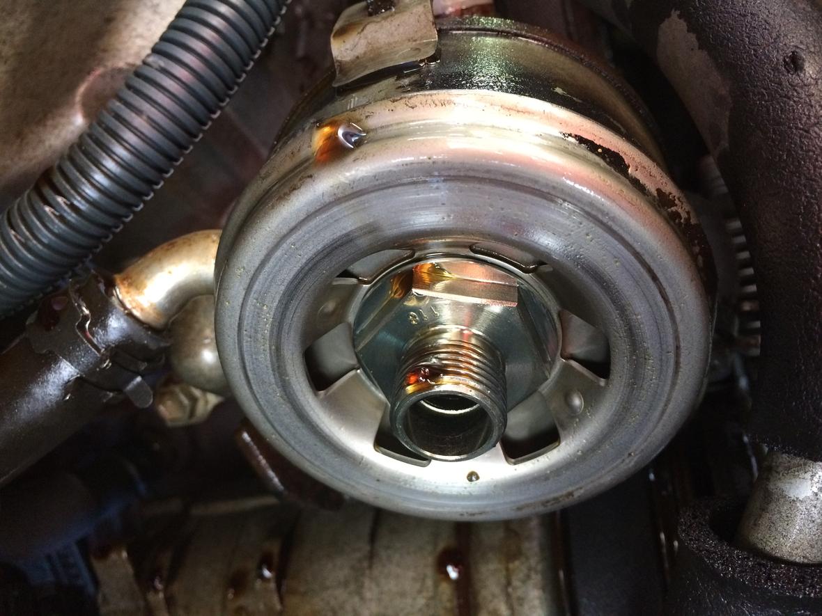

So, it seemed that the filters would spin off and hen be forcibly ejected by the jet of oil from the stem. I didn't see this happen (I did see a filter hit the ground but only from above), but since all the filters end up hand loose after Merely seconds I have no reason to believe otherwise.
The threads on every part look fine. I always check threads on filters before installation, these have all looked fine. Including the ones bounced onto the floor by the engine. No shredding, tearing or otherwise.
Photos of the stem are attached, which also looks suspiciously clean. (The drop of oil makes them look not so clean, but I looked at it and the threads are ok).

Also, those with the V8, can you confirm that this is how the oil filter base looks. To me, it almost looks like the base of an old filter is still stuck on there.
At this point, I'd suggest getting an OEM filter and trying that. If that one pops off, then we know there's definitely an issue.
I was thinking the same thing on the filter base.
Yep that's the way they look. The oil filter actually screws on to an engine oil cooler. Notice the rubber hoses on both sides? That's where the coolant goes in and out of the cooler. Put a wrench around the fitting and it screws out to remove the cooler.

I replaced the stud, although I could find nothing wrong with ANYTHING on the old one.
I screwed a new oil filter on hand tight (with oil on the ring), refilled, and connected an oil pressure gauge via some rubber hose. Started it up and worked fine.
