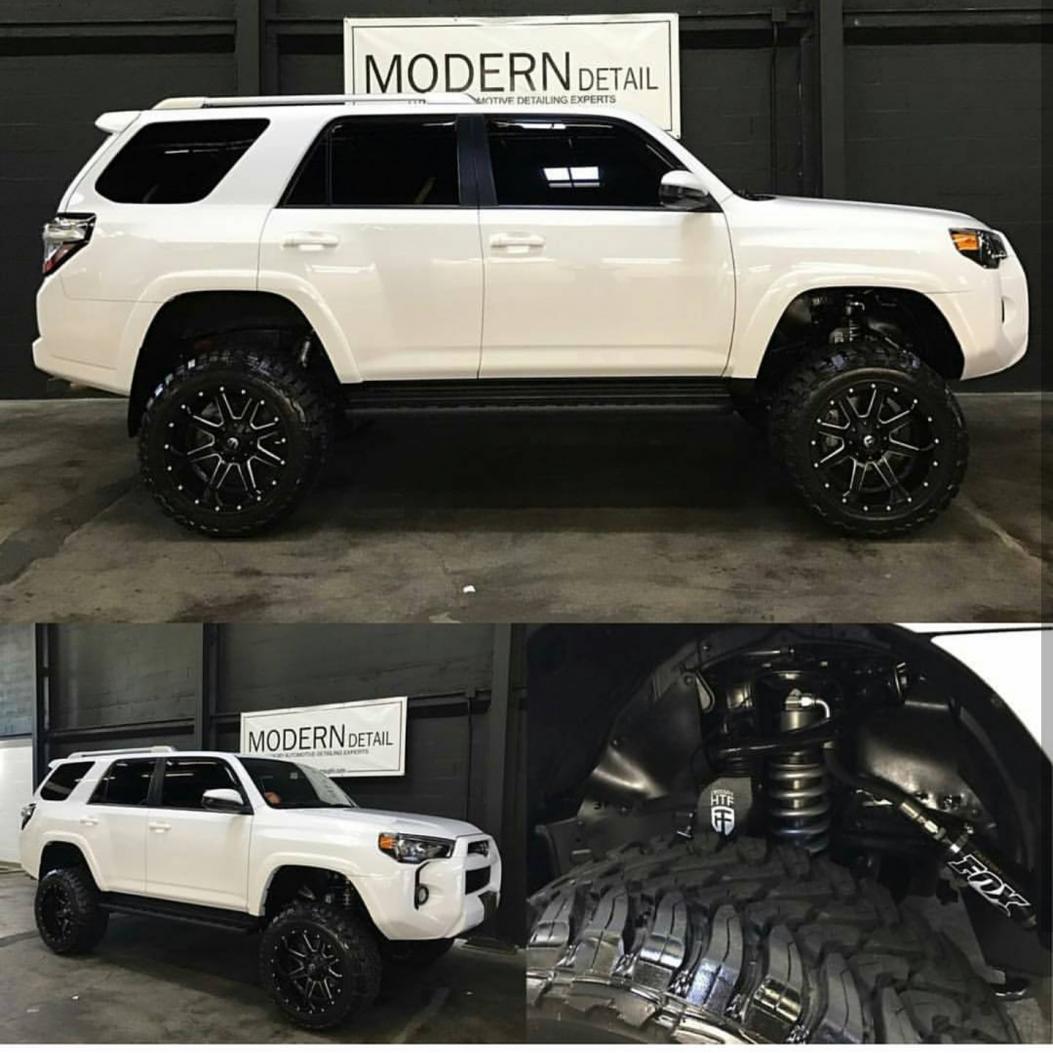

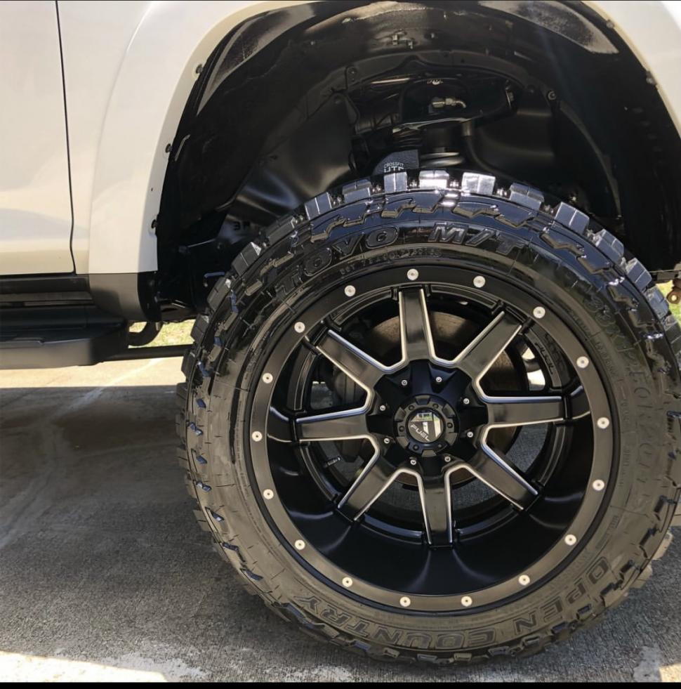

My set up
6 inch lift w 20” rims.
Thanks in advance
Can’t help with that but I’d like to see a pic of your rig w the 6” lift.
It’s in my album

Are the stock lines stretched thin right now? If you still have some wiggle and if you aren't going to offroad it then extended brake lines are not necessary. It's only needed when you flexing the suspension. If I ran LT suspension I'd get the MetalTech SS brake lines for sure.

I have wiggle room but my stock lines is rubbing against something and it’s starting to wear down. I just noticed it when I was coating suspension w fluid film. Need to replace ASAP since my wife uses it to shuttle 3 kids. I’d rather replace w stock or whatever the consensus is

There's nothing LT about that, it's just lifted to the point that the stock lines are exceeding their design, no doubt with a bracket lift of some sort.
