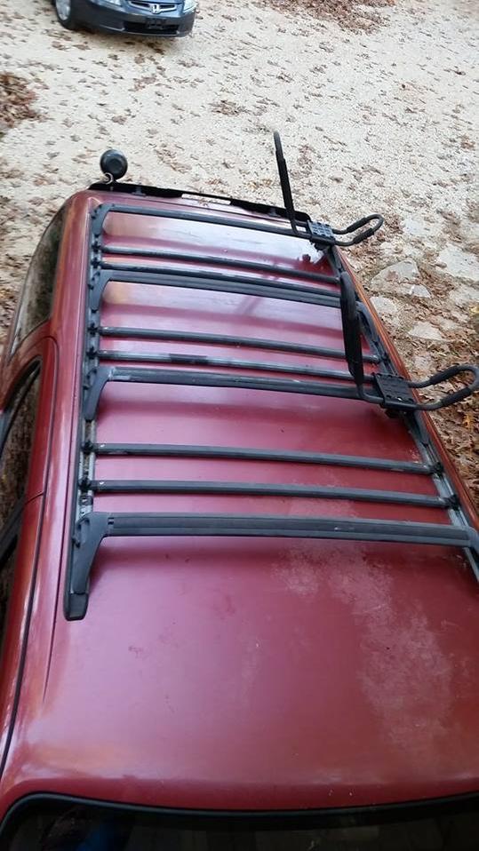

I'm thinking about adding another roof rail with rivnuts. I got some OEM rails and cut them down.
I'm not looking to carry a lot of weight up front, maybe most will be 1/3 of a kayak. The load in compression is fine, I am more thinking the issue will be the pulling out the rivnuts due to aero load or bouncing stuff. I wanted a continuous rail, but the existing ones are a bit too far in towards the cars centerline and would interfere with the sun roof so made a short one.
Thoughts?

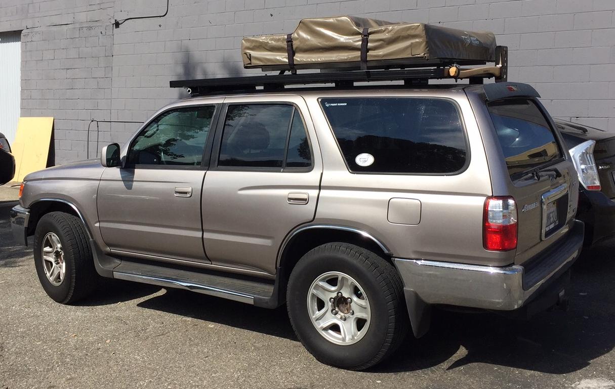

I've been wanting to do this myself. This is a guy I met on a 4runner facebook group a long while ago... Pretty sure it would still work for with a sunroof.

Not sure this is the way you want to go but perhaps it will give you some ideas.

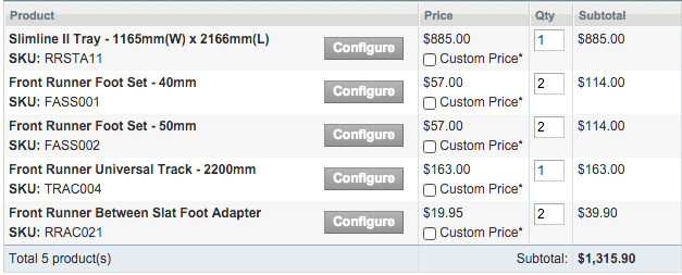

I talked with the guys at FrontRunner about this awhile back and they can do a full length setup for third gens but don't advertise it.
Thoughts?
