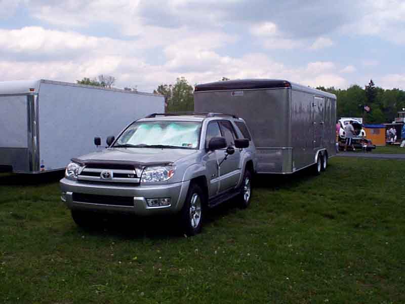

About a month ago I purchased an enclosed car trailer which is 8.5 feet wide. Since the 4Runner is more narrow than my trailer I was faced with finding a mirror solution. I tried the strap on mirrors but they simply did not give me a good enough view of things.
Then I found the McKesh Mirrors. These mirrors fit my needs nicely. It is also nice to know that I can purchase each of the parts individually should something break (out of warranty).
I have attached a photo of my 4Runner for you to check them out.
The web site is: http://www.hensleymfg.com/mckeshmirrors.html
If anyone here has other questions I will try to answer them.
As you will see on the web site, these mirrors are not cheap but I feel Safety is something one should not pinch pennies on.
FYI, my 4Runner has performed flawlessly when towing the trailer with about 5,600 lbs of weight. Traveling through the hills of Central Pennsylvania I averaged 10 mpg. This weekend I am traveling out to Western Maryland. I am curious to see how the 4Runner performs climbing the hills out there on Route 70 & Route 68 and what the MPG is for this trip.

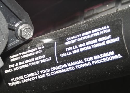

I thought the V8 was always rated at 7000 lb capability, and the V6 was 5000 lb rated.
No sir... '03 and '04 V8's in both 2WD and 4WD trim were rated at 5,000lbs. The '05s were raised to 7000/7300 for 4WD/2WD, respectively.
Having a 5,000lb limit for both 2WD and 4WD in '03 and '04 made me think it was not a drivetrain or vehicle limitation, but rather a hitch limitation. I would be curious to see if there are any structural differences in the '03/'04 and '05 rear frames/hitch receivers. If there's no difference, the '03 and '04s may very well be able to pull near the 7,000lb figure, as the brakes, wheelbase, suspension, etc, is all the same.

actually, I think (could be wrong) you're a year off. sometime mid 2003 production, some models of the 4runner (don't remember if it was only v8s or not) started to get the different hitch that was rated 7000/7300lbs. my 2003 v8 2wd had the 5000lbs hitch, my 2004 v8 4wd has the 7000lbs hitch. do a search on here, there was a big long thread that contained all the information about the different hitches that you're looking for.

The tow rating on the 2004 & 05 V-8 is 7,300#.
The hitch was changed sometime in late 03 early 04 for the increased rating.

You should able the see down the side of your
"toad".
Many people think highly of the McKesh mirrors.
I am also impressed with these: large, adjustable, well built, and stable. These do put some stress on the rubber seal of the side window but the rubber material seems to recover OK.
