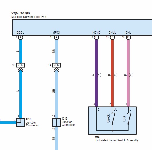

The easiest way I could think of was just basically mimicking the tailgate key hold and turn...when you turn the key one way it connects two wires together at the multiplex door ecu (found in the tailgate); and when you turn it the other way it connects the other wire. Basically just a momentary SPDT switch. I was planning to try this when I have more time, but I am pretty sure it will work fine if you run three wires from the tailgate to where ever you want the switch and hook it up to a momentary ON-OFF-ON SPDT switch. This switch may or may not work while the vehicle is running, but you can easily try this out by sticking in your key and turning and holding to see :)

Awesome info! Thanks for sharing!
