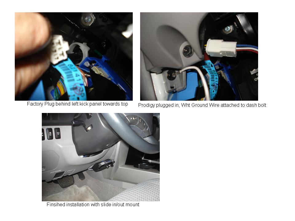

Hey guys,
I've searched and found videos on installing the Prodigy2 Brake Controller on a 2004. Is the factory plug location on the 2008 also under the kick panel, driver side near the emergency brake? My manual suggest it's under the dash near the steering column, but the diagram really sucks. Appreciate any help so I am not looking in the wrong place. Best regards, Doug
Installation complete
Factory plug is behind left kick panel, up towards dash panel.
