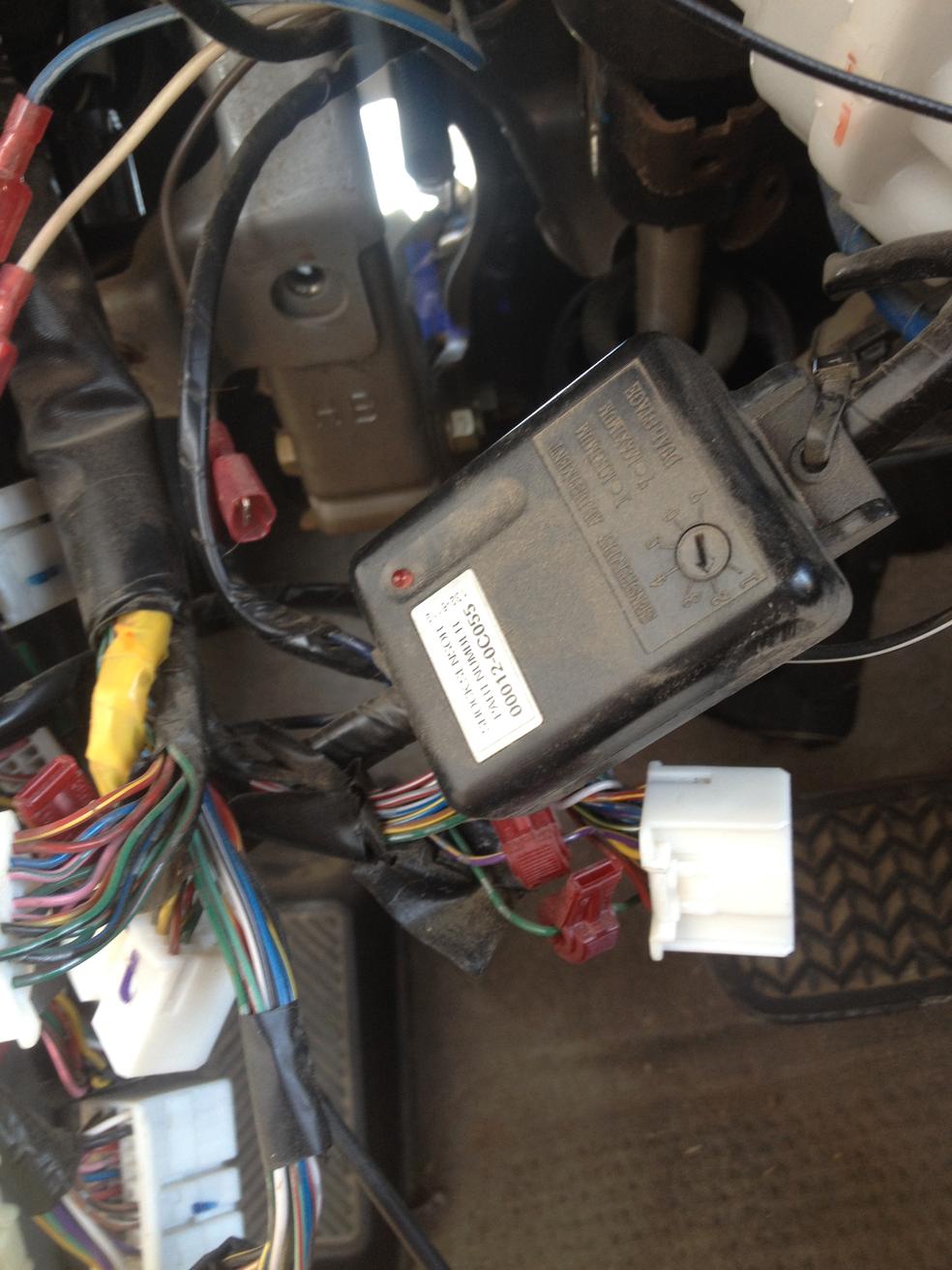

[MENTION=32290]gm350reratliff[/MENTION] is correct that it is a port installed alarm. Most likely Gulf States.

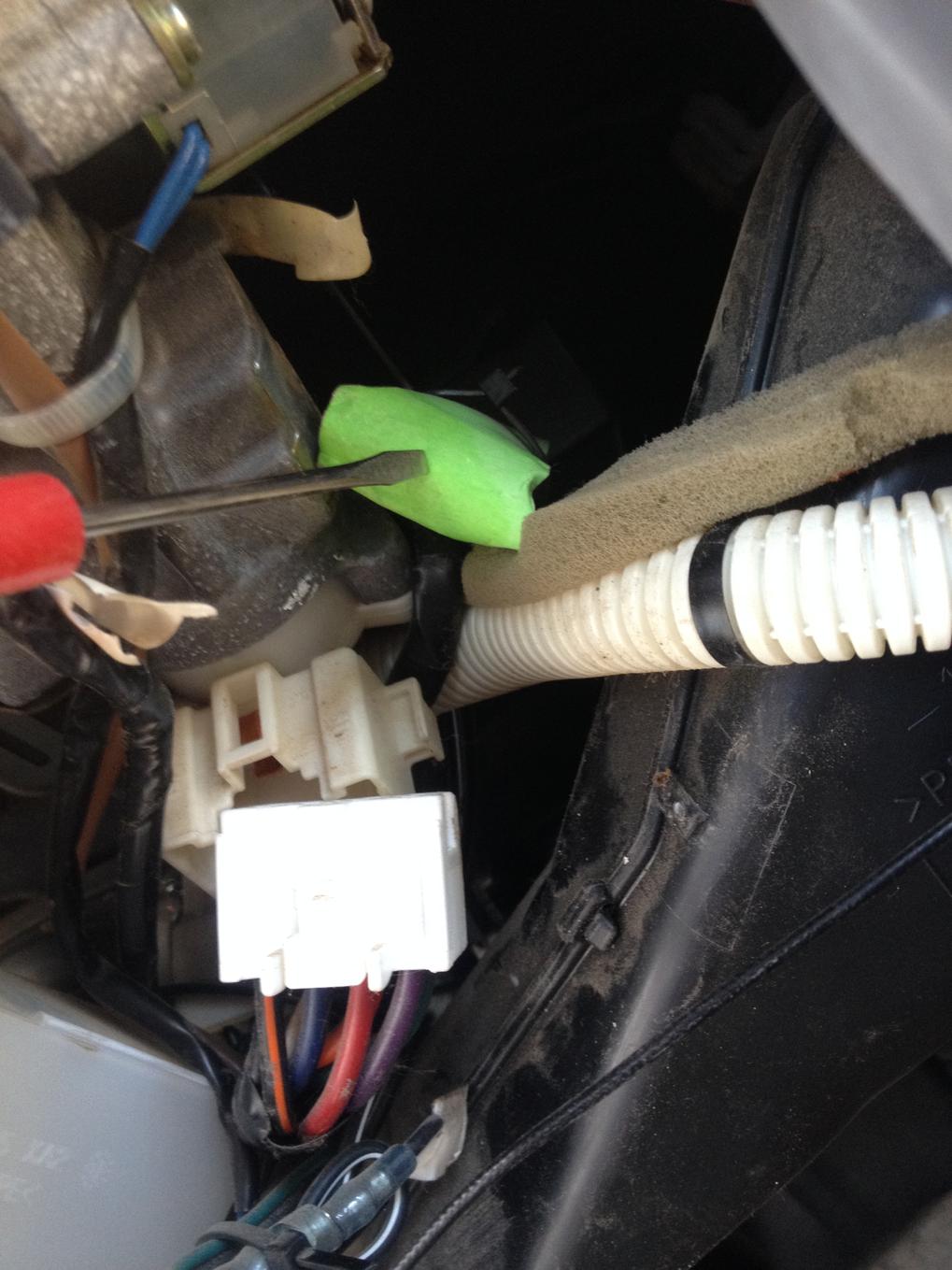

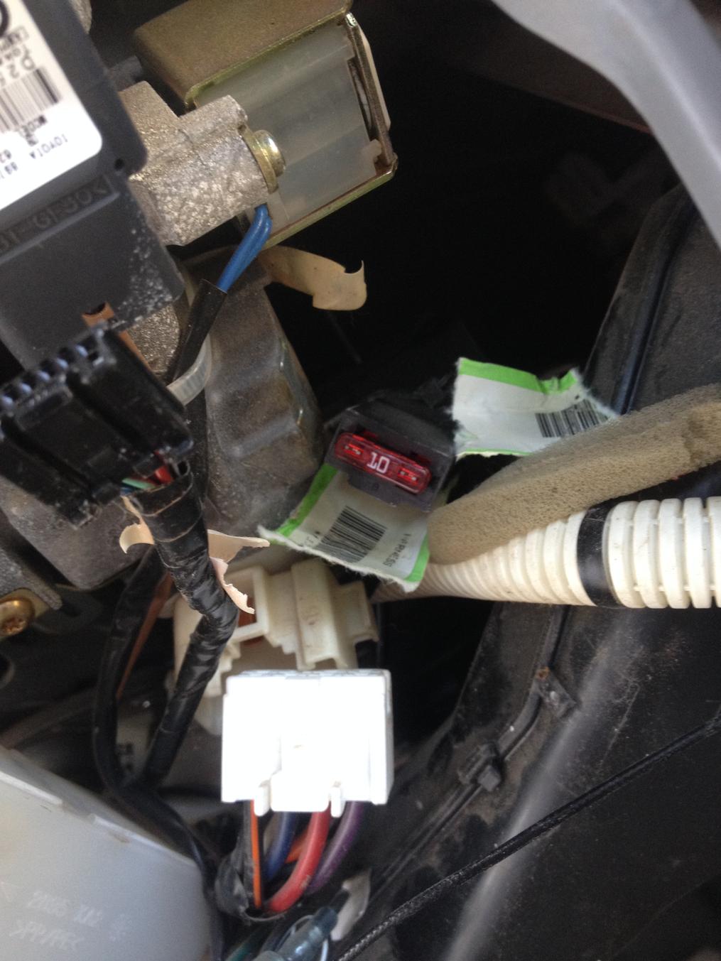

There is fuse to disable the alarm. Remove the panel under the steering wheel. Look on the right side for an inline fuse. Usually they are wrapped in a day-glow paper, mine was a light green. The paper was held on with a tie wrap on one and a rubber band on the others.
Here is the green square paper. Tear it open and there is the fuse, pull the fuse to completely disable.
You might also find the shock sensor adjustment under there too.
