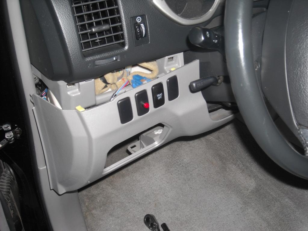

I have a 2003 toyota 4runner V8. It came with a factory/dealer installed alarm with a red (about 1/4" in diameter) button that is on the lower left dash (about 7:00 from the steering wheel). I've looked in my owners manual but couldn't find anything about it.
Here are my questions/problems:
1.) Anybody have any info on this alarm? I never mess with this button.
2.) Last night I was sitting in the living room and heard 4 or 5 really quick horn honks come from the truck. Looked outside and all was quiet. Looked at the remote and it wasnt depressed or anything. This is the third time it has happened. Anyone know whats going on or ever had this same problem?
Im thinking it may have something to do with this red button/alarm.
Any info would be great! Thanks in advance.

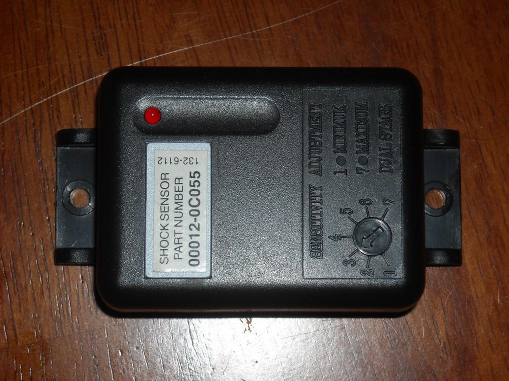

Was the wind blowing when this happened? Mine started doing that just before the shock sensor went out on it. It only did it maybe for 5 or 6 times (that I heard) for about 2 weeks and then one day, I could not set the alarm. I could not even lock the doors manually or the alarm would go off. I had to leave it unlocked or else. The next day I went and had an aftermarket system installed.

So after talking with a good friend who use to do car alarm installs, he thought it might be the shock sensor going out. It was pointed out by someone else here on the forum that could be the culprit as well.
So today I started at the red led and traced the wire directly to the shock sensor. It was located right by the steering column. I unhooked the shock sensor and pulled it out.
If this doesnt stop the mysterious horn chirping in the middle of the night. I am going to pull the "main security box", which I located while pulling out the shock sensor.
I would like to note that after I pulled the shock sensor I locked and unlocked the truck a few times to make sure everything was kosher. So far so good.
Attached are a few pics if anyone else ever has the same problem. Tommorow I am going to get back under the dash and take a pic of the main control box. I may go ahead and take it out so I dont have to worry about it anymore. Hopefully, the problem is resolved.
