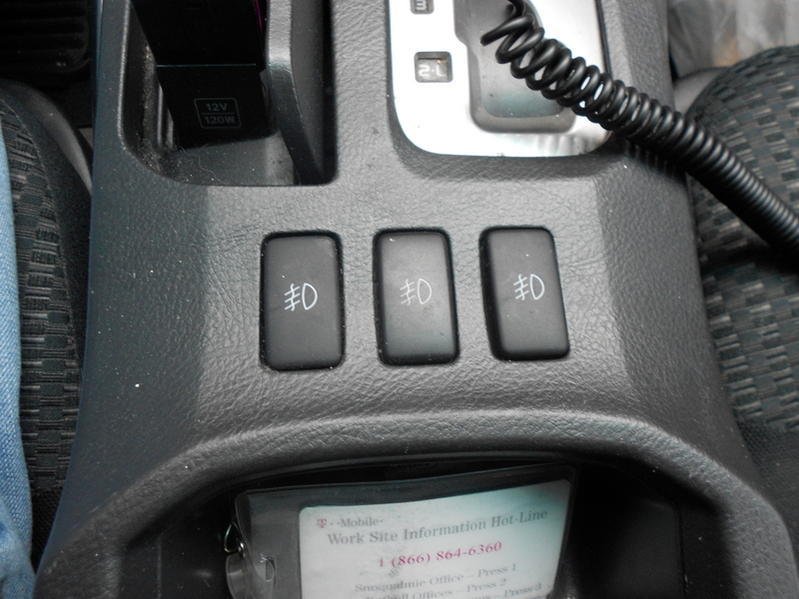

I am adding some fog lights and I want to use one of the blank slots on the center console as my on/off switch for the lights. Can I buy a universal rocker switch that drops right in or does it have to be factory Toyota switch to fit ? I don't want to drill a hole for a toggle switch.

+1 I have these. You have to trim the openings a little bit on each side with a razor blade knife, but they slide right in. Only issue is that it's easy to bump them on with your hand. Wish I could find a guarded switch that fit.

I was looking at those switches and I really like the Zombie switch lol. I think that is the way to go. I see that you went with the amber color. How close to the factory color amber do they match?
I just ordered the Zombie Lights switch. From what i've heard it fits pretty well, just have to do some trimming, just like what was said a few posts up from here.

PT297-35070-AS
You may also want to go ahead and get the switch harness
PT297-35070-SH
