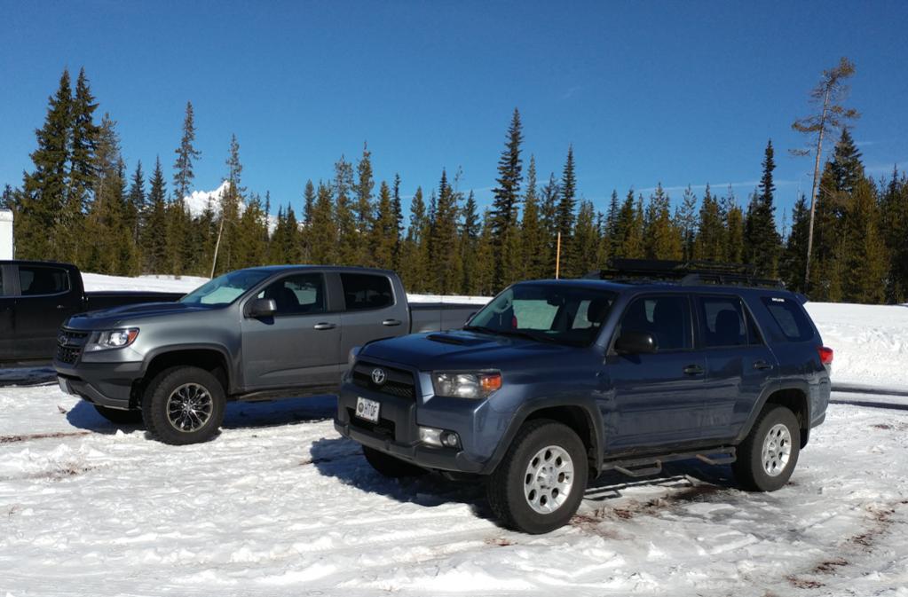

It would have been fun yesterday in 2h when I was trying to get it loose in a turn in snow messing around with a guy in a ZR2. His Duratracs really hung on.
