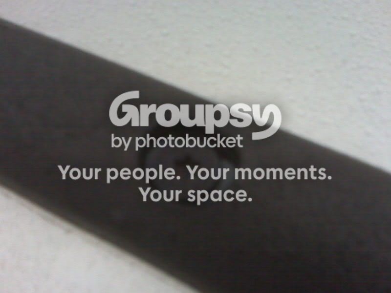

Well I ended up ordering the factory rack from eBay and I just picked up the "outer skid strips" from the Toyota dealership. When I went out to install the skid strips that's where I ran into a problem. What tool do you use to remove the screws that are holding down the strips? My standard phillips head wouldn't fit. Here's a crappy picture of what they look like, but I imagine they're the same as everyone else's who has the factory rack:
a2f6d08d.jpg~original
Can anyone who's removed their rack tell me what kind of tool I need to use to remove those?

You need a Torx head bit. At least I think it's called Torx. If you can't find the right size, try using a regular screwdriver (not Phillips) that will fit into 2 opposite notches in the screw, push down hard and turn it slowly. You should be able to get it out if you're careful. If it stars slipping, I suggest you stop because if you strip that little screw head, your screwed

Yeah as soon as I realized the phillips wasn't doing the job I stopped because if I had tried any more I would have started stripping it. I'll go to Lowes tomorrow and pick up a Torx screwdriver. Thanks for the info! And from what I'm reading on Google, the screw is a Torx-8 screw, and I guess they make different sized bits for the different sized Torx screws so I'll have to make sure I get the right size.
