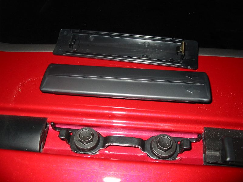

I just took off my racks on my 08 sports edition 4runner. After much searching found parts needed to replace rack.If you remove the cover where your racks should mount.you will find a bracket with 2 bolts.To remove cover push on cover in direction of arrow and pry up on opposite side.Should pop off.To install just snap it back on. Remove that and thats where the roof rack mounts.Bellow is a picture of a Rav4brackets and cover,but its exactly like the 4runner except the cover looks slightly different. Would sell you mine but shipping would be killers from Hawaii.
