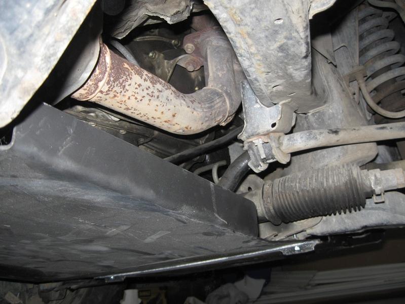

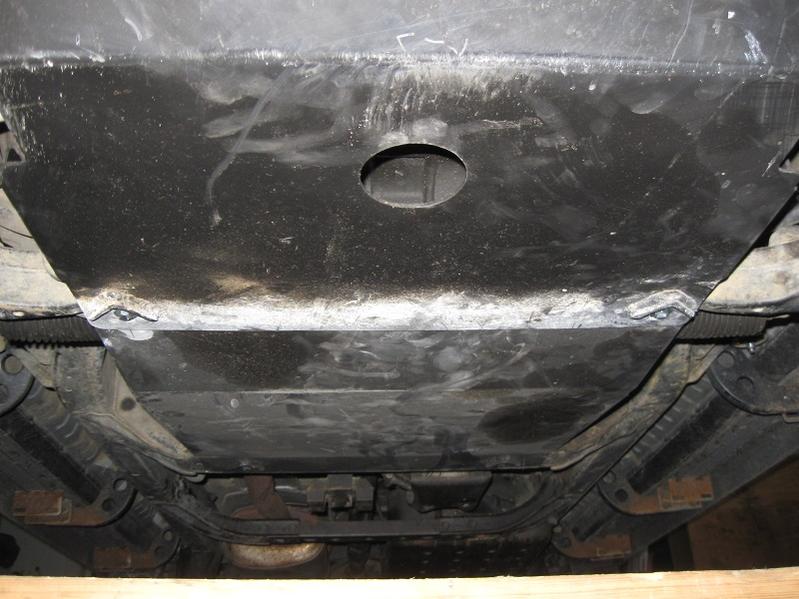

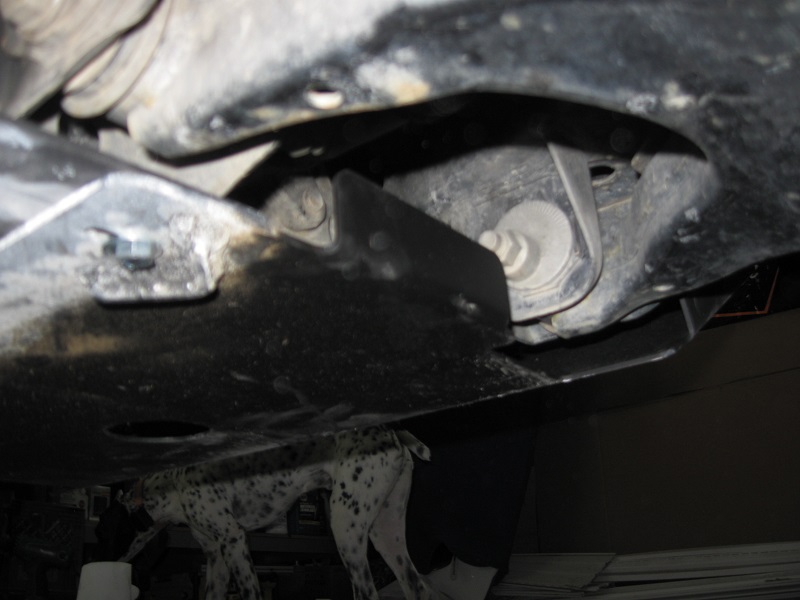

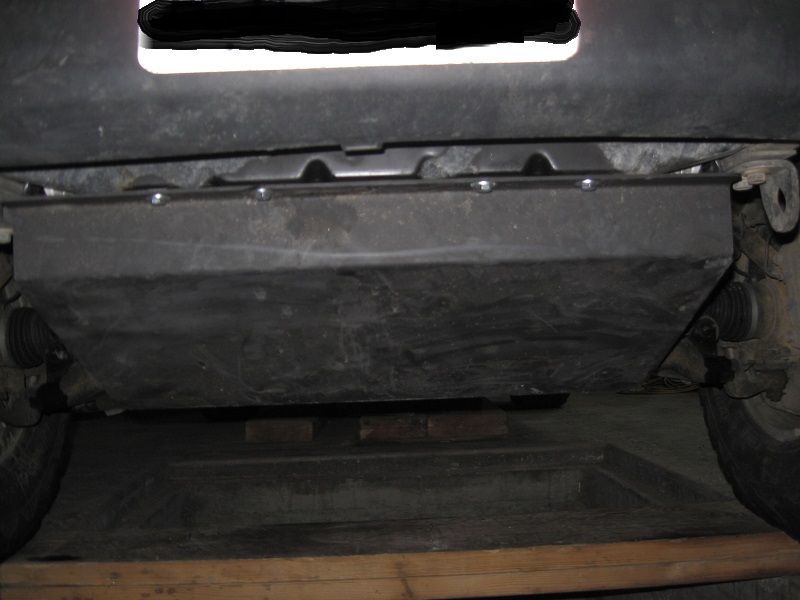

I had the factory on my two 95's and they were fine for dragging off a road edge, brush, etc. My 96 did not have one when I got it and drove it for a year without but only took it on back roads a few times. Now that I am using it like my 95's (DD, Hunting Rig, more crap being driven over) I put an aftermarket skid and tranny plate. I got it off here on a group buy from a member isu2014 who designed and made them up. They were a super great price and extremely well made. I went with the 1/8" and it will handle A HUGE amount of abuse. I also welded the bolt protectors on and painted them. I should have drilled (and will shortly) a drain hole for the tranny.
