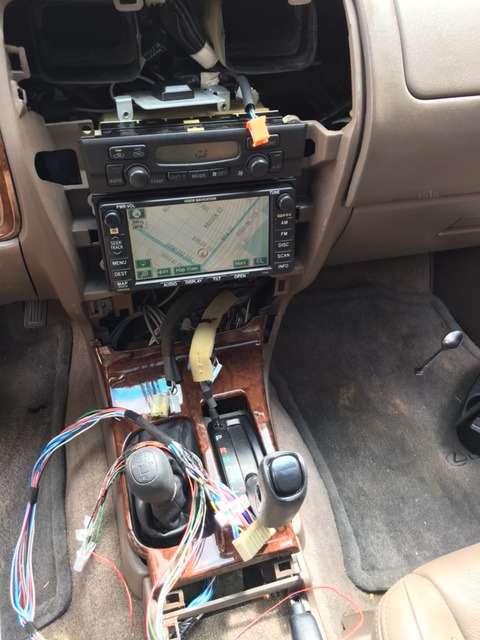

Toyota Sienna JBL NAV E7006 w/JBL Amp wired up. Works flawlessly!:

Diggin' the Sienna nav unit...was it difficult to wire up?
Thanks! The wiring was a pain i will be honest. A metra harness and variety of colored wiring made it alot less frustrating, but still a pain. If you need help wiring it, let me know.
