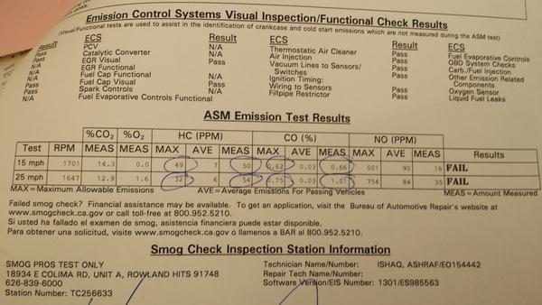

I took my 2000 Toyota 4Runner in to get it smogged back in July. It failed. I replaced the spark plugs, wires, air filter to K&N, the first O2 sensor and both cats. I retested it today. I've been running 91 octane gas for the last 400 miles. Please take a look at the numbers in the screenshot below and see if anything jumps out at possibly being an issue or some direction I might be able to take.
The only thing I am thinking of right now is right before the test and 10 mile drive, I added Seafoam to the gas tank, thinking that would help. After reading some other posts, it looks like I should have waited a few gas tanks after I added the Seafoam to test. My mistake.
Secondly, I never reset the ECU when I changed the catalytic converter 2 weeks ago. Might it still be adjusting? Thanks for any information.

Yes...I originally ran the smog test with seafoam in it. Refilled gas and ran for a couple hundred miles. Retested and failed again. This was the 3rd fail. I now have it at a smog test and repair shop that saw the print outs and felt they could troubleshoot the issue. I just got a call from them a little while ago. They said the issue was the PCV valve.
WTF.
That was one of the first things I changed out. I went to Autozone and picked one up. Its a common $5 part...right? Well...the technician said it was a generic aftermarket part and it was causing the emissions test to fail. He replaced it with an OEM one and that cleared up the emissions.
