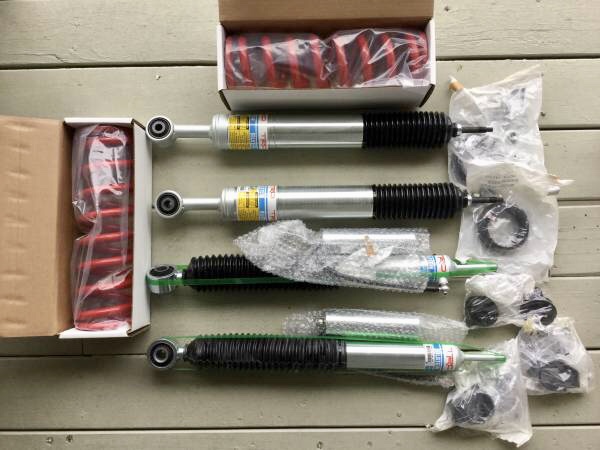

Found Brand New in Box FJ Pro Set up for $800. Guy is Firm on Price. Seem Fair?

Gotta drive up to Flag to get them too? Personally I think you would be happier with a set of Billstein 5100 and a set of OME springs in that price point. If it were me I would save a bit more and just get the OME complete setup from Toytec.
Before dropping any serious money on anything, maybe reach out to 4x4 groups in your area to see if someone near you has a similar setup and will let you ride shotgun for a few miles to get a sense of how it feels. That’s the tough part about choosing a suspension - it’s not like a shirt you can return if you don’t like the fit.

I assume this is the same as the 6112 / 5160 combo? If so, the price looks pretty dang fair considering the regular cost of these parts.
The 60mm shock up front is pretty noteworthy upgrade over the 5100... not much else can be had for this performance level without spending a good deal more.
