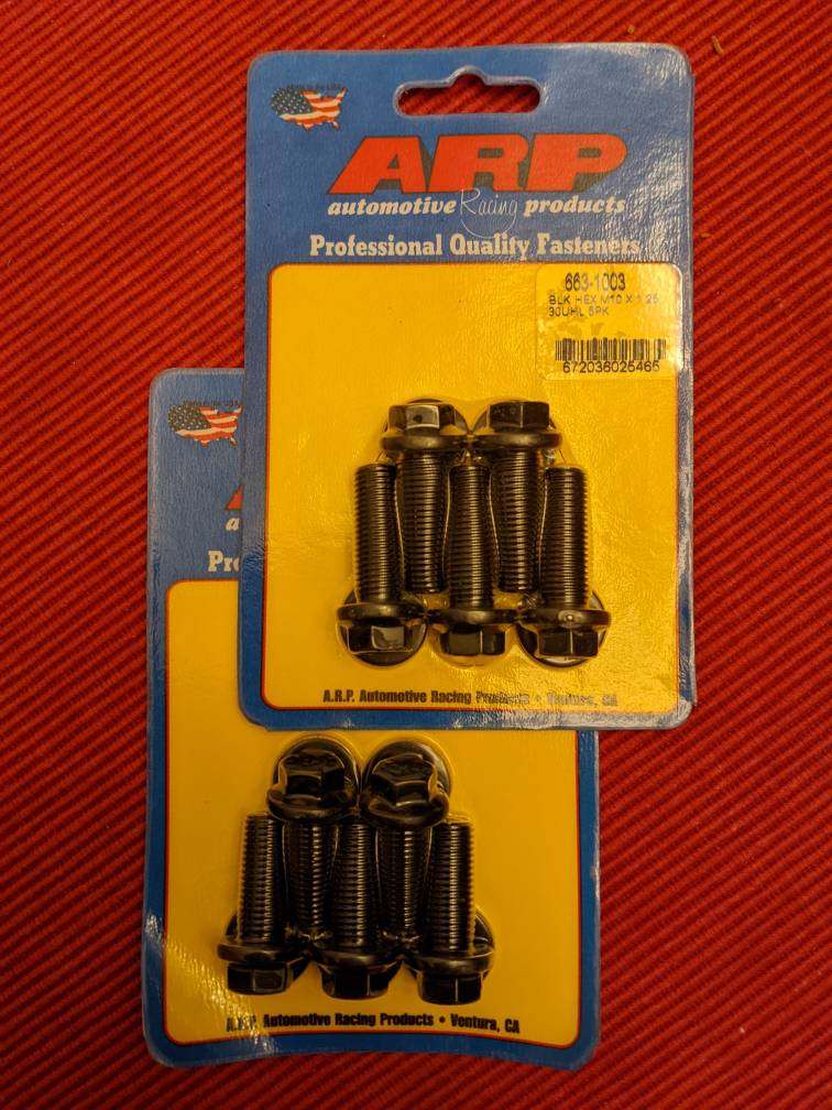

Or you can upgrade to ARP bolts for the LBJs like I did
Stainless Steel is PN 763-1003

I'm not sure if those work with the OEM LBJ dust shield and I have no experience with them so I did not recommend them.
They have a smaller head (12mm) and same size shoulder/flange as factory and lower torque spec (54 lb ft) with higher tensile strength.
I've had zero interference issues with the brake dust shield but I'm not familiar with an OEM LBJ dust shield.

The bolts for 01-02 that are compatible with the lbj dust shield/cover (90119-10933) have a captured washer instead of a flanged bolt head. Which is the reason the torque value is different. If you use the flanged lower ball joint bolts you will crack and damage the dust cover/shield.
Gotcha, I see the difference now
The different LBJ bolts and why it's important, Prado 90 Series — Mighty 90s Forum
My 99 doesn't have that dust.cover, but the ARB bolts come with non-captive washers which could still potentially work, but I can't/won't attest that they will or wont
