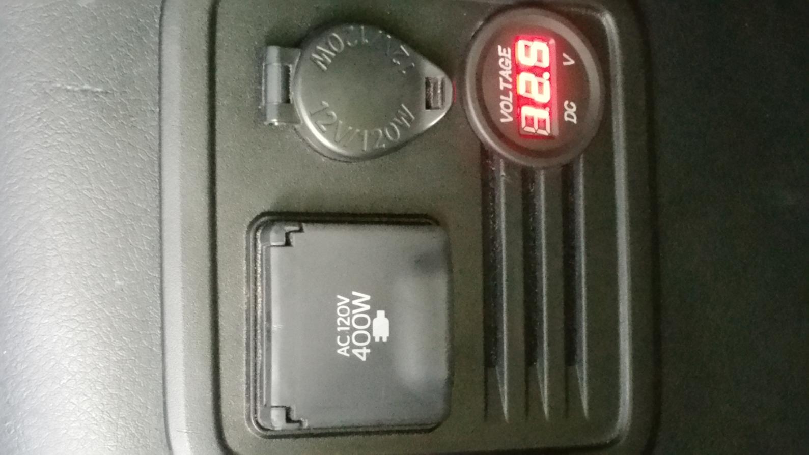

And I'm not doing much with the current one. I actually modified the stock outlet to accept my plug and fatter wires straight from the battery. Finished that today actually. Started it, then played some drunk kickball, then finished it. It was a good learning and intermission.
Pushing through the firewall sucked to say the least. I should have pulled the little rubber grommet way earlier...
I fought with it for too long and got frustrated...
Oh well done now. Voltmeter and terminal block and all. Done and complete. Thanks for the info!
Great work, glad you got it done!
I am curious what you mean by you "should have pulled the little rubber grommet way earlier"? Do you mean the main firewall grommet on the driver side? Or some other grommet? Did you put it back in?
I am always open for a beer and car talk, no charge.
Yes, the firewall grommet (I went through the passenger side though)! I was trying to push through it without removing it for fear it would be hard to get back into place. So I spent a few mins grunting and annoyed at trying to shove through it at the unsightly angles. Then I pulled the grommet out into the engine bay, pushed the wire through, then pulled the wire through while providing resistance on the grommet from the inside. Short work after that.
And yes I put it back haha thanks for askin though haha. Some people who have never pulled wires through the firewall may not be so savvy. Lol

Got it. I was definitely not questioning your wiring prowess. I have had a beast of a time getting through the grommet but never just pulled it for fear of it being an even bigger beast getting back in. But I know that the hole where the grommet sits has a folded / rounded edge, so there is no sharp sheet metal edge, hence why I wondered if you had just ripped it out. Glad you got it back in.
