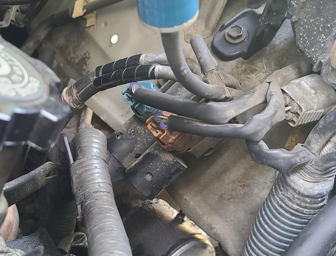

Anybody know what these things are? I'm starting to eye the evap system and everything around it as the culprit. I noticed that I only get the ticking noise when it's cold out - once it warms up outside (the weather only, not the car) it goes away. To boot if I'm real low on gas in the morning I could hear the ticking at idle, and it seems to stop if I unplug the purge valve. I'm curious if vapors are maybe playing a role here
