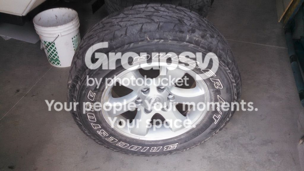

And new wheels, thanks Inv4drZm!
yes, yes I know, crappy picture but its all I have right now.
[/URL]~original[/IMG]
